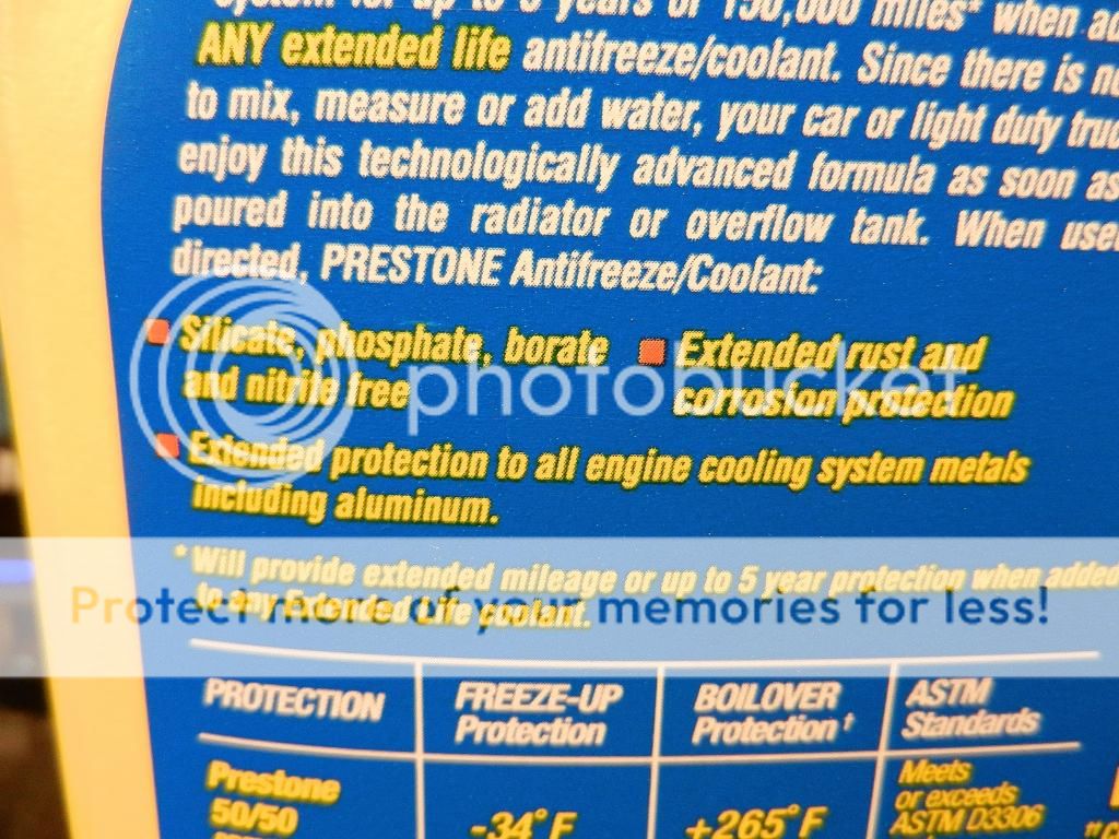

Here Ya GO...This is what is in my bike.....no problems

I also used the prestone 50/50 pre-mix yellow bottle as shown above bought at walmart when they had the rebate on bottle if you buy one gallon jug, mail in the rebate to receive the 2nd gallon jug for free, great deal and has been 3-4 years now since changed the coolant.  Will wait until a few more years around 6 years total (guessing 20K+ more mileage) to change it up again.  Not that hard to do and I figure the OEM stuff was probably in my bike doing just fine (although was not correct color, more dingy/darker) from 2001 to 2009 (8 years and 15K miles).  I think the bottle says 5 years or 100K and don't know too many cycle riders doing 100K in 5 years so will wait to change another 1-2 years past 5 years.  Others will disagree though changing it out every 2-3 years.
