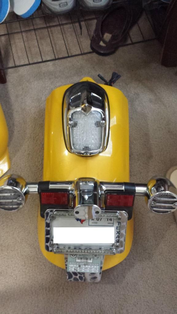

I'm with BF re. the clear lenses. This is my setup and not with the brake lights on....clear lens with red Radiantz LEDs. Many outfits don't have as many LEDs in their product as Radiantz, makes a huge difference. I have since added small quarter size flashing LED lights between the bags and fender in back. They alternately flash extremely bright like lights on a patrol car.
