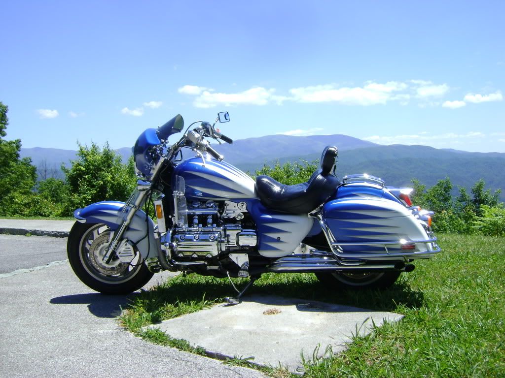

I think the rails are a great looking and functional item to add to any hardbag valk.  The standard loop guard in back will protect the bags in a stopped tip over or drop, but maybe not in a more serious fall/slide... and the bags are expensive items to find, replace, paint, yada.  Some guys have made them quick release, but most don't, and all I have to do is pull the bags and work around the rails for all rear end maintenance.  And those rails are strong enough to jump up and down on with the bags removed
I do not like and would not add the trunk guard, and when you look around, few interstate guys with bag rails have the trunk guard (it looks perfectly fine that way).  That said, I did rub my trunk on the door frame backing out once (and the guard would have caught it), but it rubbed out easily.  Moving the bike in and around tight spots, driveways, parking, the bags are much more likely to get hit than the trunk.  While the bag rails are frame mounted (independent of bags), the trunk rail mounts to the trunk plastic, so in a traumatic incident, they'll just punch holes in the trunk at the mount points.  And supervalked, who needs a rail on the trunk in storage anyway?
As far as matching goes, the better match for bag rails, is a front fender guard/rail, and of the Honda or MC Enterprises, (IMHO) the MCE definitely looks better with a curved rather than straight profile of the Honda.  I have the MCE on my supervalk, and have been going back and forth on adding it to my full interstate since I got it.
Both my interstates have Honda rails, and both took some finagling (and extra hardware/bag bottom mount spacers) to mount and I hear the aftermarkets are fine and also take some finagling.  You put it all together completely loosy-goosey, then go around tightening.  It was a lot harder decision when Honda OE were the only thing available, and they were $650 and way up used, if you could find them.
Front fender Honda guard.
Front fender MCE guard.

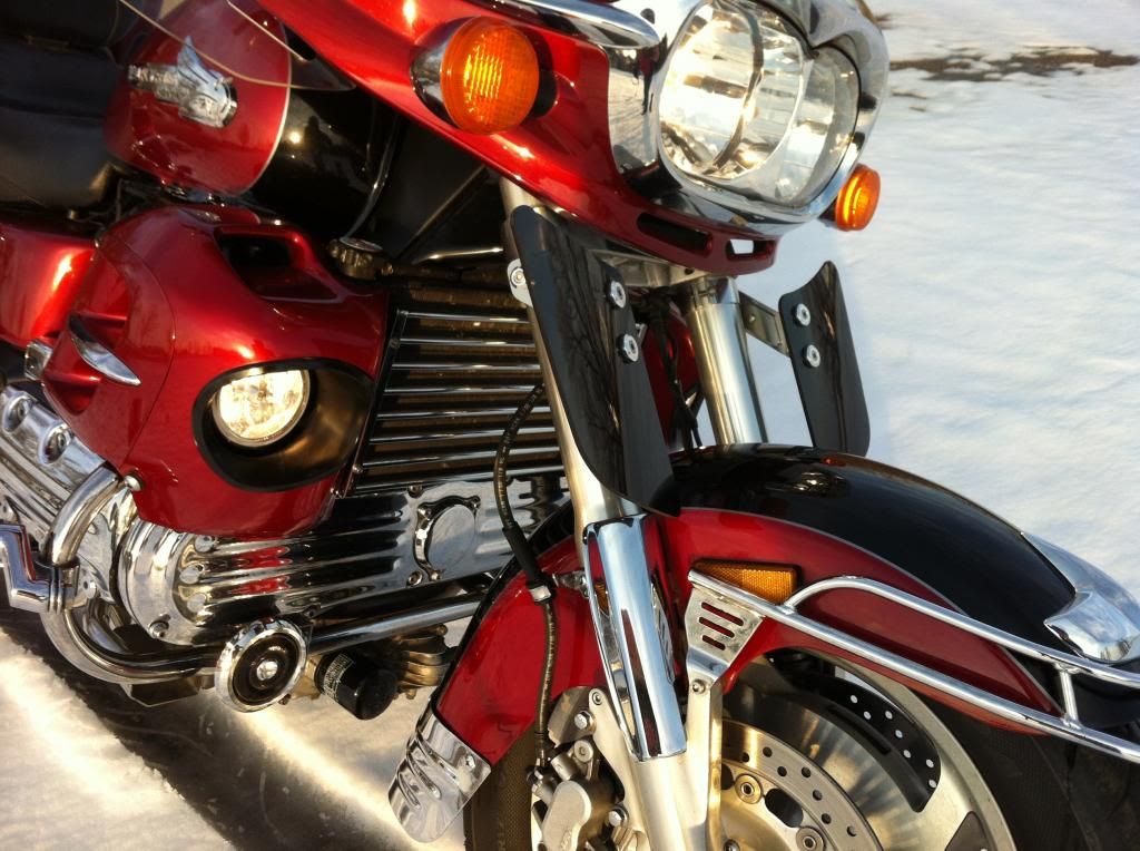

The bag rails are a nice touch and they are truly "safety chrome".  As said earlier they take just a bit of tweaking to get in place, and you will have to buy a couple of spacers at your local hardware store for the mounting on the bottom end. (To difficult to describe but is pretty noticeable once you're installing them.)
The rail on the top trunk is another story altogether; to say the least it is a prickly project.  It is best to to take the trunk off and sit patiently in a comfortable spot.  Tape up the outside of the trunk so you don't scratch up the paint in the MULTIPLE fitting and sizing exercises.  It is sincerely a test of patience to get it just right . . . not kidding.
The chrome lid covers on the side bags and trunk are pretty easy to install.  Just lay them on there for a while and see what looks right to you.  Mark around the outside of the studs with a pencil and drill away.
The front fender chrome is easy to put on.  Warning though, the Hondaline (flat front) has a stud on it that requires you to drill a hole front and center of your front fender.  Which means the bike will probably always have that piece of chrome with it.
As  you know there are aftermarket pieces for a variety of looks. What appeals to you is foremost.

Oldfishguy,  LOVE that mostly red with a hint of black 2-tone paint scheme on the Interstate, my favorite of all time and rarely ever seen.
VERY nicely decked out as well, just be careful in that pic of the VAlk in the snowy parking lot doing donuts.    Looks like ready to head out ice fishing  Cheesy
