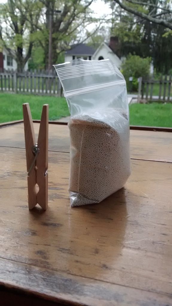

After 7k+ miles with the air soft BB's in my tires, going back to the ceramic balance beads.
I've found that the air soft bb's are causing a "ridge" (for lack of a better term) along the center of my front tire. It's a slightly raised center that simply refuses to lend itself to a good photograph.
After some reading I now believe this to be the cause.....
[From the Innovative Balancing site.]
"Weight per unit of measure (g/cm)
The heavier it is, the less product it takes by volume to do the job. You get too much material in the tire, and it can't concentrate it's weight into a small enough area. Due to centrifugal force, the extra mass of material ends up "flattening out" over a large surface area, defeating it's efficiency."
I switched to the air soft bb's because the ceramic beads "stick" inside the tire. The air soft bb's always move to new positions every time you roll out, (which is what you need a dynamic balance medium to do) but are taking up too much "space" along the center of the tire & flattening out over too much area.
I guess (for me) the solution is going to be take a "fish bat" to my tires every week or three, when they're cold, to knock the balance beads loose inside & let them reposition for wear.
Sooooooooo, here's the link for 10 oz's of ceramic beads at a reasonable price. They're not in the little EZ throw in pouches, but at 2 oz's front & 3 oz's rear (CT) you can do 2 sets of tires for 20 bucks!
http://www.amazon.com/TyreBeads-Tire-Balancing-Beads-Motorcycle/dp/B00FBTQ29I
Oughta balance a few tires don't ya think.
(Clothes pin is to illustrate scale only! Please do not install inside tire!)
Peace, Whiskey.
