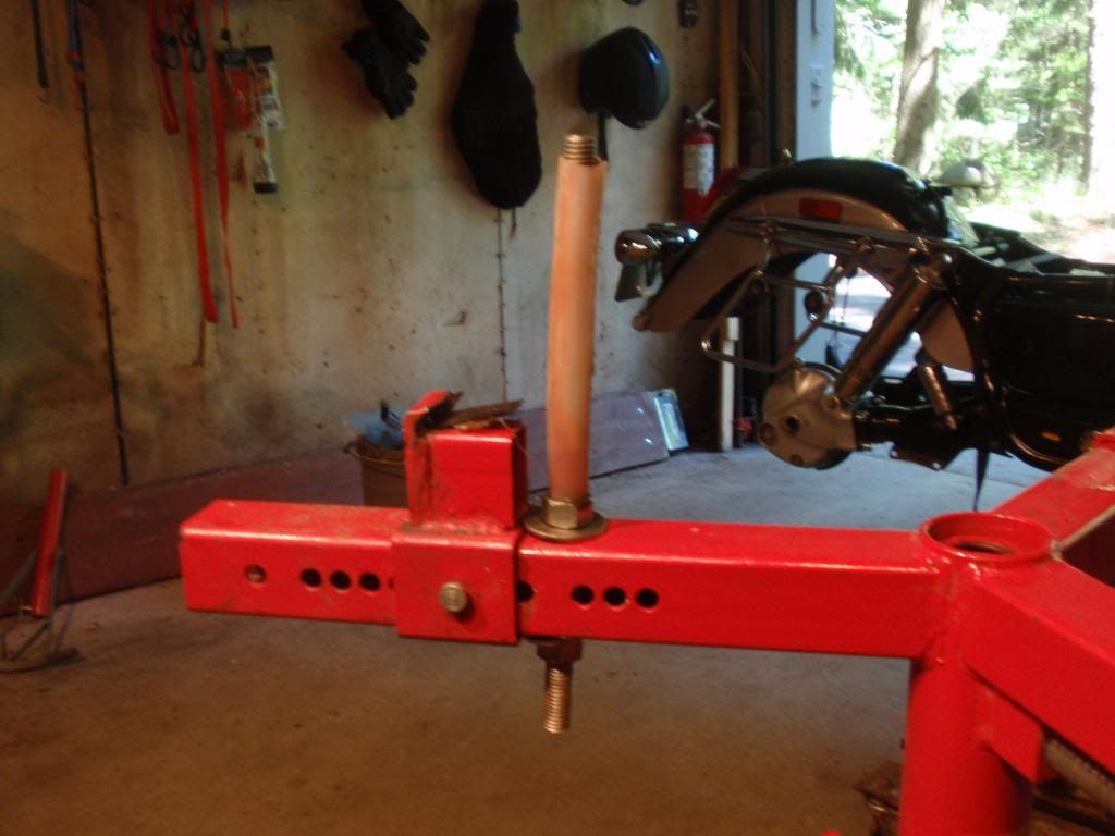

I have had the HF changer with adapter for about a year and a half.  I don't know how any of you could change a tire at all with the setup.  I modified it and it works well.

This is one adaptation I did to keep the tire from turning.  The rod comes up between the (spokes)
What all sizes does that little mod work with?  Or do you have different holes for diff sizes?

I have a 1999 Standard and that one hole works for front and back.  I did a couple of tires for a friends Goldwing too.
I've done some car and trailer tires too but they have a different system to hold them.

And Cookiedough's mod of using steel rod to hold the tire in place is a good one. With the nylon mojoblocks, the tire tends to want to turn on the nylon while putting side torque on the lever. Remember to add a piece of hose over the rod to keep from scratching the rim with the threaded rod.
