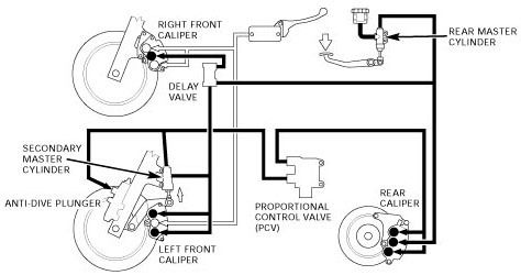

I had my Gold Wing done at the local dealer (Santa Maria, California).  It was a positive experience.  They ordered the parts, called me when they came in and scheduled a service appointment.  It took a little over two hours to do the work, so I just waited at the dealer and read a book.
It involves changing out the secondary master cylinder (left side of front fork) and the rear master cylinder, flushing the system, and bleeding the brakes.  They do not flush the front master cylinder that is on the handlebars.

Correct, they're not interconnected in the way most people think they are. It's the "mechanical" secondary master cylinder that applies the rear brakes when the front brake lever is used.
Glad you've got a dealer you can count on. cooldude
Front brake gets you Red & Black,
Rear brake gets you Blue & Black,
but the black is actuating no matter what, if its working properly.
