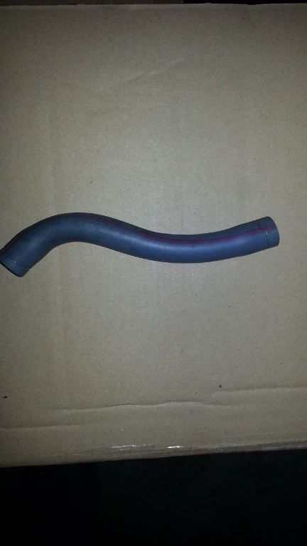

Finally done with the bathroom remodel and finished working on my daughters garage, back working on the 98.  Took if for a good ride and had some problems, engine cutting out then coming back sometimes so back in the garage and pulled the tank, but couldn't find anything wrong so took a closer look at the fuel lines.
As you can see the line going to the left bank of carbs has a slight dip in it.  Forgot I was going to replace this but got in a hurry to hear it run and forgot.  Found out you can replace the fuel lines without removing the air box.  Wasn't easy, had to take a needle nose pliers stick it in the end of the fuel line to open it up enough so I could slide it on the T's.  Working great now, next step is to use my new digisync then fine tune the carbs.
