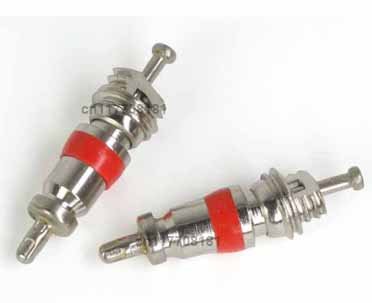

« Reply #2 on: April 21, 2016, 10:26:28 AM »
It sounds like the rubber part of the core that seals against the inside of the valve stem (the red part in the image below) is failing.  I would replace the valve core, were I you.  If you are using the original valve stem, I would certainly replace that with an all-metal one at the next tire change.
EDIT:  I re-read your post and saw you replaced the core.  Perhaps the surface inside the stem that the rubber seals against has a nick in it, or perhaps some other contaminant?
