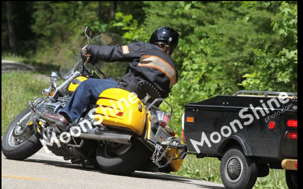

Britman, I saw on BPP's post you had ordered one of these.    I didn't want to crap on his post so I started another. I assume you had seen my link to it when i mentioned it in another post. Just wanted to let you and everyone else that is thinking about this tire I am impressed with it especially considering the price. I am running 38psi in it and showing some extra wear in the center. Taking that into consideration i still don't know that i would adjust pressure to extend tire life. Hopefully Ky,Dave will chime in and remember the mileage when he installed the tire.  I have over 7000 miles on it currently + what Dave put on it when he owned the bike.  The handling IMHO is pretty good and no issues in the twisties. I got a few compliments from the guys i rode into inzane with from Knoxville on how well it went through the turns pulling a trailer. No issues dragging pegs and feels stable at any angle.
Went through the back of the dragon and tail of the dragon on the way home from inzane + smokinjoe and his buddies took us through some pretty twisty roads on the way there too. I have a lot of 75-80+mph time on the slab with the tire too. With and without the trailer. Also it behaved fairly well on gravel roads.
Let me know what you think when you get it installed and a few miles on it. DISCLAIMER  I may be biased since this is the only CT i have any experience with

Nice shot Mark. I'll have to check records for mileage I had. I know from experience weight of a trailer drastically reduces mileage on the rear tire. Will get back with mileage when I get a chance  cooldude

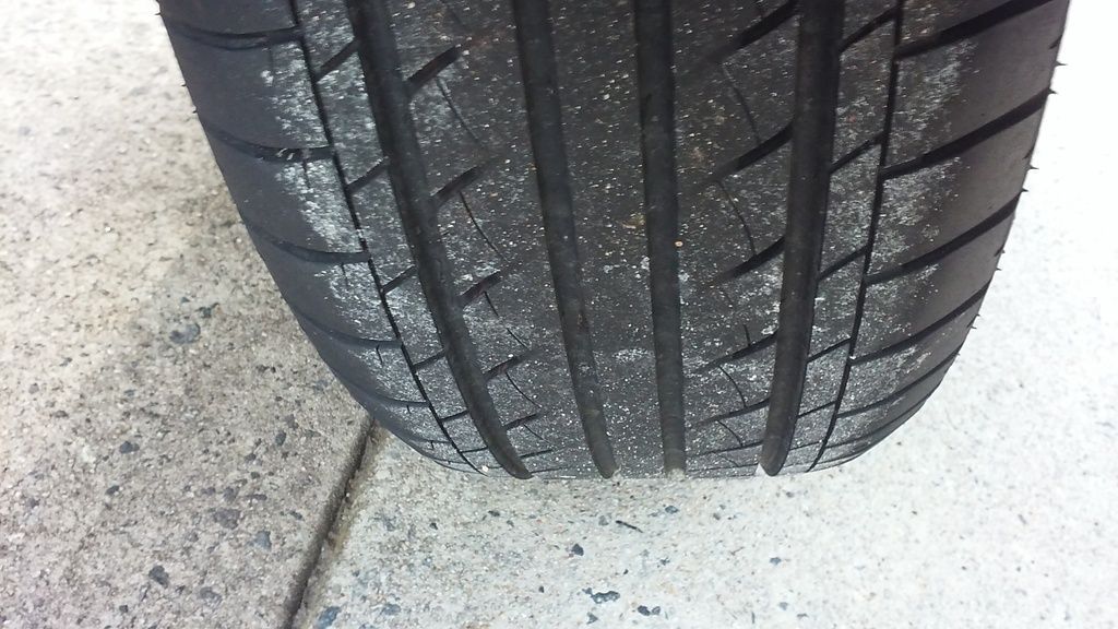

« Reply #12 on: November 06, 2017, 01:02:42 PM »
13,500 miles
Saturday coming is forecast to be dry and that will be the last ride for this tire.
Another 1,000 possible on the main tread but no more wet roads for the shoulder.  cooldude
« Reply #13 on: December 05, 2017, 01:30:19 PM »
14,000 miles.
Looks like it has some life left until you compare with new.

« Reply #14 on: December 05, 2017, 04:09:07 PM »
Heck, I'd run it for another 1000.

Having worn off the tread on the rounded shoulder I had no idea how much rubber there was left before there was no rubber left.
