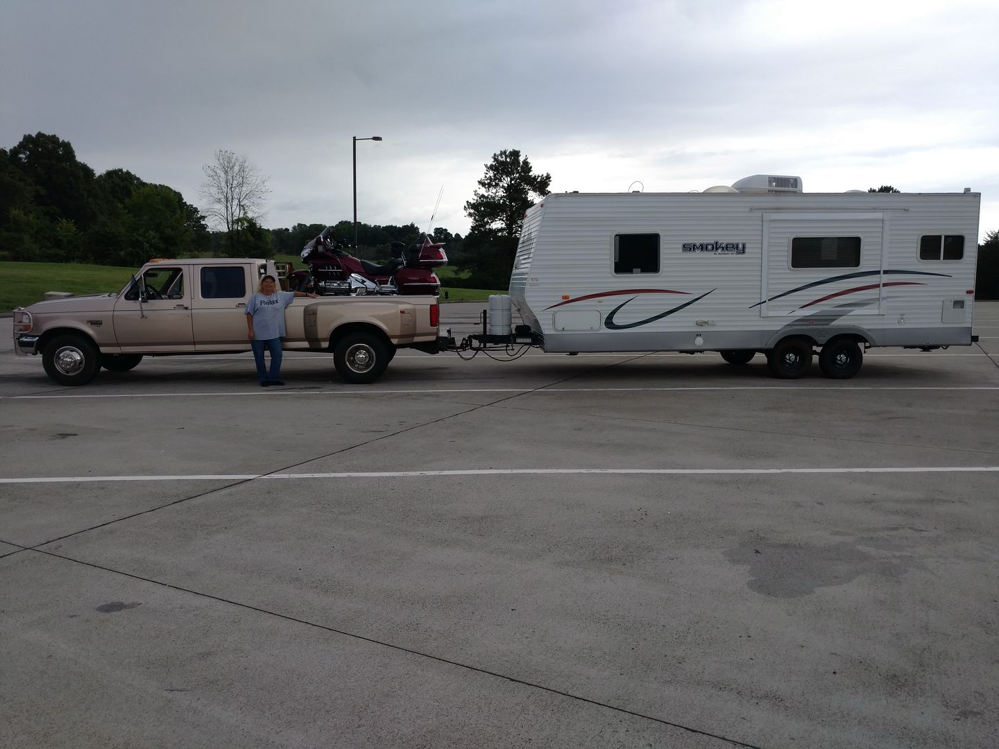

We've got the Wing in the back of F350 diesel dually, with a 22' travel trailer in tow. (Gets 20mpg fully loaded on interstate.) We chose this particular set up for only one reason, we like some pretty small outta the way places. With this rig I still need 45' spots & a fairly level place to unload bike. If I wasn't frequenting small primitive campgrounds,
it would definitely be a fifth wheel toy hauler.
As someone else here said, once you pull fifth wheel you'll never want another bumper pull. I jus' didn't want the length involved in a fifth wheel toy hauler. To get something comfortable with a garage capable of hauling the Wing I was gonna need a much longer trailer & would be limited to "RV" type camping, that's jus' not our thing.
The smaller toy haulers (with the bike in the living space) are barely capable of handling an 800+lb machine IMO. Not to mention unstrapping the bike & going out in the rain with it every night, jus' to hafta go out first thing in the morn & reload/strap the slick wet monster again to get underway?
No, the "type" camping we do determined the size rig we were lookin' for, & the limitations/conveniences desired in a rig that size ultimately determined the set up we needed. I guess I'm sayin' a lot depends on "how" you camp. (We tend to go someplace & stay awhile.)
If you're not plannin' little bitty, out in the woods, forest service type primitive campgrounds, I'd strongly urge you to reconsider your stance on fifth wheels (I think you'd be glad ya did) & whichever way you eventually go, it's gotta be 2 axle for a bike this big.

« Reply #24 on: August 12, 2017, 06:48:36 AM »
I like the rig, but how do you get that 'Wing in and out of the truck bed without killing yourself / damaging the bike ? Obviously, the bike is in the truck bed before you hitch up, and it's an 8 foot bed...

Now you're making me wish for a full size pickup with an 8 foot bed - preferably 3/4 ton or larger Smiley
