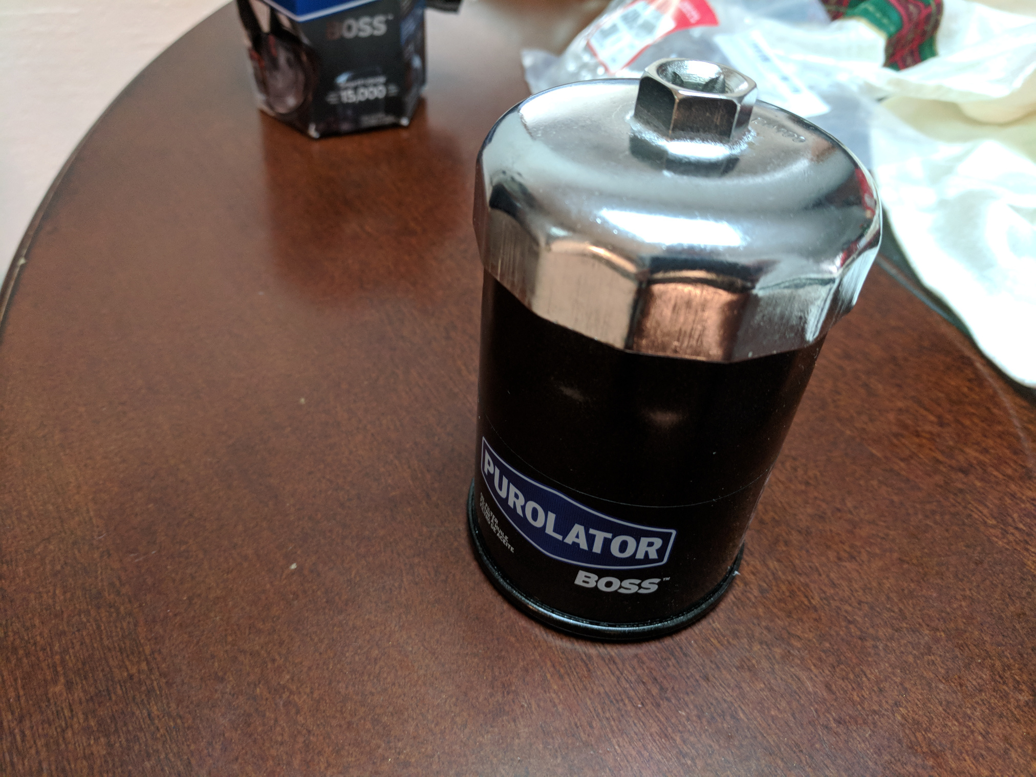

Last Sunday while removing the faulty K&N filter in my St1300, I decided to do the oil change and use the Rotella T6 5W-40.
Also moved from K&N to Purolator Boss Black (good for 15K miles).

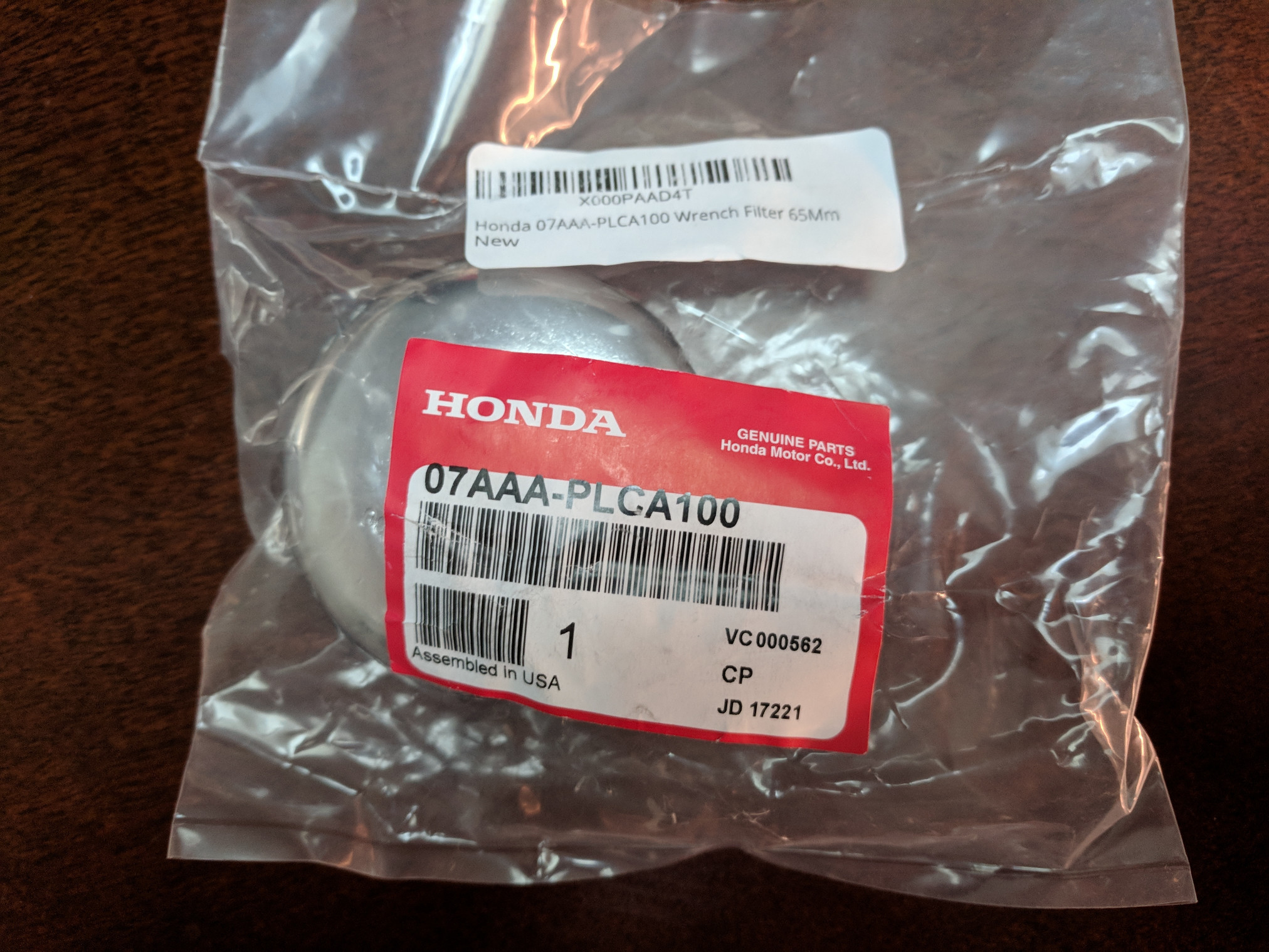

And the last but not the least, could use the new Honda oil filter wrench (07AAA-PLCA100). I can't recommend this wrench enough, even though the oil filter is readily accessible in our Valkyries, in a ST1300 it is hidden in the lower-middle of the engine block.
Another major advantage of the Honda wrench is that you can use it with a torque wrench (or an extension).
Let's see how the Rotella T6 is going to affect (or not) the gear switching.

« Reply #1 on: November 28, 2017, 03:41:33 PM »
Nice option there, Ive always used my old strap wrench except for once used my giant channel locks when I couldnt find the strap wrench that was hanging right in front of the bike    uglystupid2 .  A screwdriver will also work in a pinch but I havent had to do that yet
Only hand tighten the filter (pureone 14610)  Still have a few of the yellowish ones and a few gallons of the blue jug rotella  Always good to have extra !
Good luck with the combo  I am happy at 108k or so

« Reply #6 on: November 28, 2017, 05:14:15 PM »
Channel lock pliers here standard procedure. What puzzles me is why when I hand tighten all oil filters is the Valkyrie filter so tight at removal. The one on my truck comes off easily by hand.

« Reply #11 on: November 28, 2017, 08:34:17 PM »
I have the same issue a few weeks ago and every year I put on hand tight but go another 1/2 turn or so  not fully tight with the oil filter wrench but maybe 1/3rd of a turn from tight all the way.   EVERY single year the oil filter on the Valks are hard to get off, harder than they should be.  Now, my kids 97 magna piece of cake comes off very easily same oil filter used as well.  Weird for sure..

« Reply #12 on: November 29, 2017, 04:58:38 AM »
has to do with the amount of heat that part of the engines sees. The Chevy 350 back on the 70-80s were known for oil filters that didn't want to come off for same reason.
remember only to turn 1/2 turn tighter after filter gasket touches the engine filter surface. always check for leakage while engine is idling, might need an 1/8 turn more.

« Reply #13 on: November 29, 2017, 06:27:52 AM »
having just changed 3 oil filters in past few weeks on 2 valks and 1 magna,  the oil filter once touches goes about 1 full revolution (give or take) fully tight with a wrench, so you would think 1/2 a turn of the 1 full turn until tight-tight should be easy to get off, right???  My 2 valks super hard to get off while the 97 magna piece of cake and I changed all of them last time.
Posts: 13658
« Reply #14 on: November 29, 2017, 09:07:30 AM »
just checked a purolator box, and it has 3/4 turn by hand. I have always done it by hand, never a wrench.
