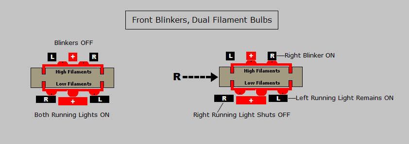

The rear signals use single filament bulbs. They only have a high filament for signaling. They go dark when not signaling. The fronts are dual filament bulbs. The low filament in the front bulb is used for running lights (constant ON) so they don't fry the sockets. The running light has it's own switch that shuts off for the duration that the activated signal is flashing. This creates dark moments between blinks to make the individual blinks more distinctive. Below is a graphical representation of how the running light switch works. Note that the contacts on the running light switch are transposed, right is left, left is right. The running light switch is ganged to the turn signal switch, essentially a double pole, double throw switch. That said, there's no law that your front turn signals must function as running lights in addition to the headlight.
