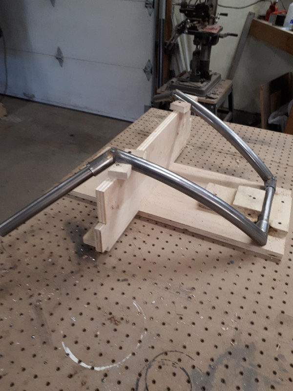

Hi Guys,
I decided that my 1" bars looked too small on my bike, so I did up some new ones with 1-1/4" bar.  They look nice and beefy compared to the old set.
In the picture you can see the difference between the 1" bar used for the hand grips and clamps and the 1-1/4" bar used for the arms.
The bars were just tacked in this picture and have since been tig welded by my cousin and primed.

I am 5' 11".
The bars that I made give me about 8" more pullback from the OEM bars.  The OEM bars are 8" long and these bars are 16" long.  They allow me to sit back in my seat and the bars come to me, I don't have to lean forward to reach for them.
I will give you first dibs on the bars.  Don't forget though, that you will have to lengthen the wires for the switches on each side, brake & clutch hydraulic lines and throttle cables.
Here is a picture of me on my bike.

« Reply #7 on: April 11, 2018, 06:39:33 PM »
Hi Turboyoshi,
The OEM brake line is 21" long.  I added 8" for a total length of 29"
The OEM clutch line is 52.5".  I added 8" for a total length of 60.5"
On both the clutch and the brake lines there is a 45-degree banjo end that connects to the masters
On the clutch line it has a straight banjo end that connects to the slave cylinder
On the brake line it is a block to screw in the other brake line that goes to the line splitter for the front brakes.  You can see this connection on the right side of your bike at the steering neck.
update:  here are the pictures of the ends.
Brian
« Last Edit: April 12, 2018, 07:23:00 AM by bscrive » Logged

« Reply #12 on: April 15, 2018, 02:22:46 PM »
I got the new bars on my bike and everything else put on.  I think I may have made these ones a tad longer because I had to modify the banjo bolt at the clutch master for the line to be long enough.  It was a minor setback and for a little while I thought I might have to buy another line that was 1/2" longer.
The thicker bars look better on the bike.  I took a few pictures, but you really can'r see the bars in the garage.  Too many black coloured objects.  I would take the bike outside for a picture, but mother nature thought it would be funny to dump 4" of snow last night and give us almost an inch of freezing rain by tomorrow morning.
I am sitting at my computer listening to the freezing rain hit our windows and the wind howl.  It's a temporary setback.  It is supposed to get a lot warmer by the end of the week, but now we have salt back on the roads and we need some good heavy rain now to clean that off.  Maybe that will happen this week.  It was a good day to work on the bike in my garage.  It's heated and very comfy for doing stuff.
