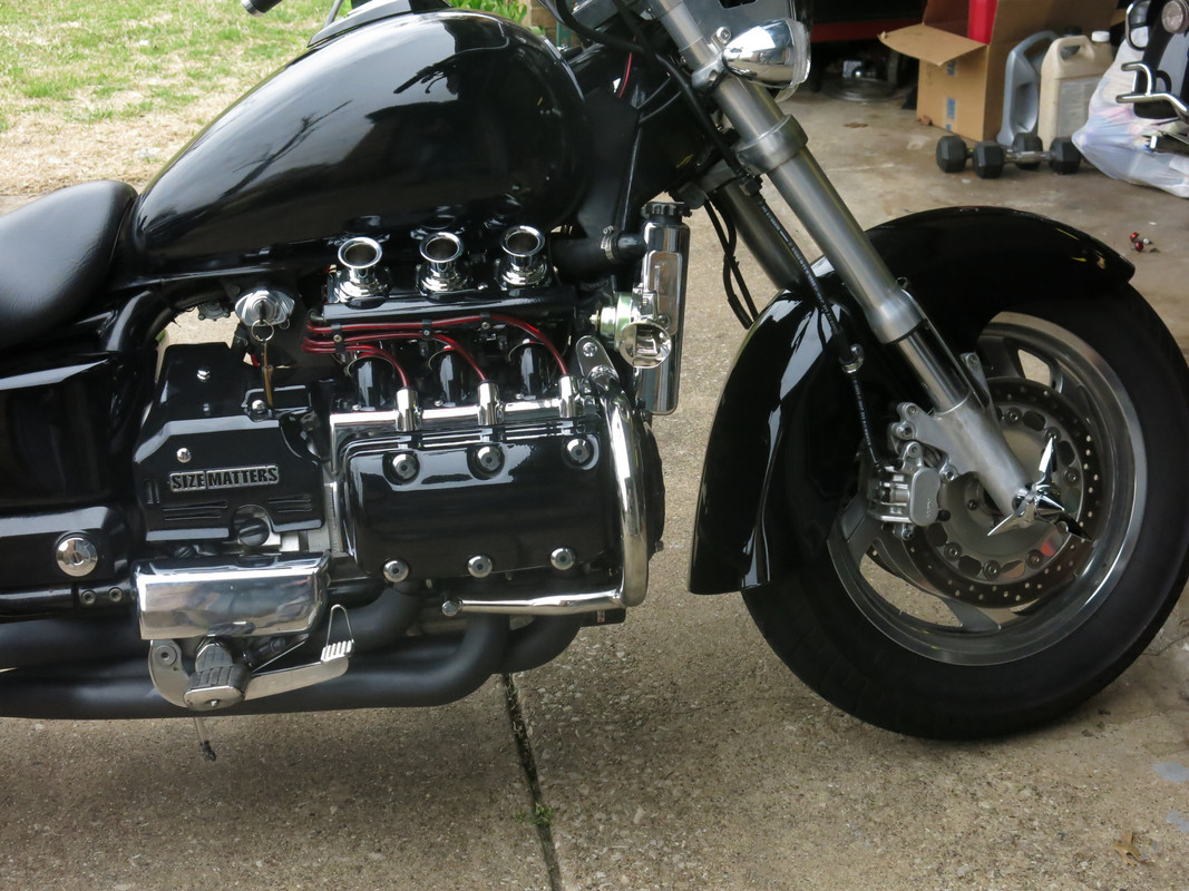

« Reply #8 on: April 19, 2018, 12:58:46 PM »
So here are some pix of my Wolo installs.  Sorry they are not much to brag about.
The standard has a new home now so this is all I can do.  Buy me a beer I can probably do some added pix for the Interstate.
This is the installed view on right of the standard.  Tried some closeups.  I used angle aluminum and mounted to the hole where the OEM used to be.
This is the left.  Again, angle aluminum using an existing bolt.
On the Interstate right side I used an empty existing hole on the engine mount below the ignition switch.  I used a piece of stainless I had and bent into a Z shape.  If there were no transmission covers I could have pushed this in tighter to centerline.  Note this is the Big Bad Max and the horn outlet is on bottom where the Big Boy outlet faces out the side.  As mounted it just touches my leg but not enough to annoy me.
On the left side I used another piece of stainless bent in a Z shape and an existing bolt in the engine mount.  I pulled the bolt (5mm dia?) and bought one that was longer to ensure full thread engagement with the horn mount and the ground wire added.
I used both Wolo relays and each has its own fuse.  I also bought some shorter bolts as the Wolo ones were too long.  I disconnected and removed the OEM horn and extended that harness under the seat to the new relay trigger connections.
