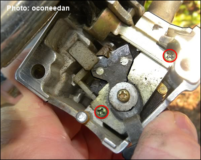

All it takes to deep clean the switch is removing 4 screws. Two screws to separate the clamshell housing, then 2 other screws circled below. 20-minutes max. for the entire project. I wouldn't do anything with the pivot screw for the thumb lever because it's almost impossible to screw it back again with the right amount of tension.

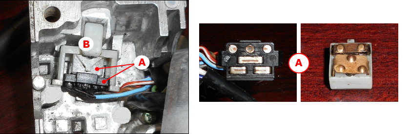

After the metal plates above are out of the way, pluck the plastic holder (B) from it's notch in the lower clamshell. Then you'll be able to clean off the movable & stationary contacts (A). The holder is just friction fitted in its notch. No screws.

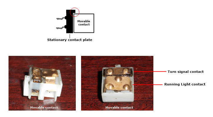

Just spraying contact cleaner without taking apart the movable & stationary contacts works for a while. But the crevice between the movable & stationary contacts is very thin and the stationary contact plate has a ledge (red circle) which makes it hard to direct the contact cleaner to where it should get to. That's even with the thin straw attached to the spray can's nozzle. You end up just moving residue into the crevice where the residue collects on the upper contacts which is the turn signal contacts.
