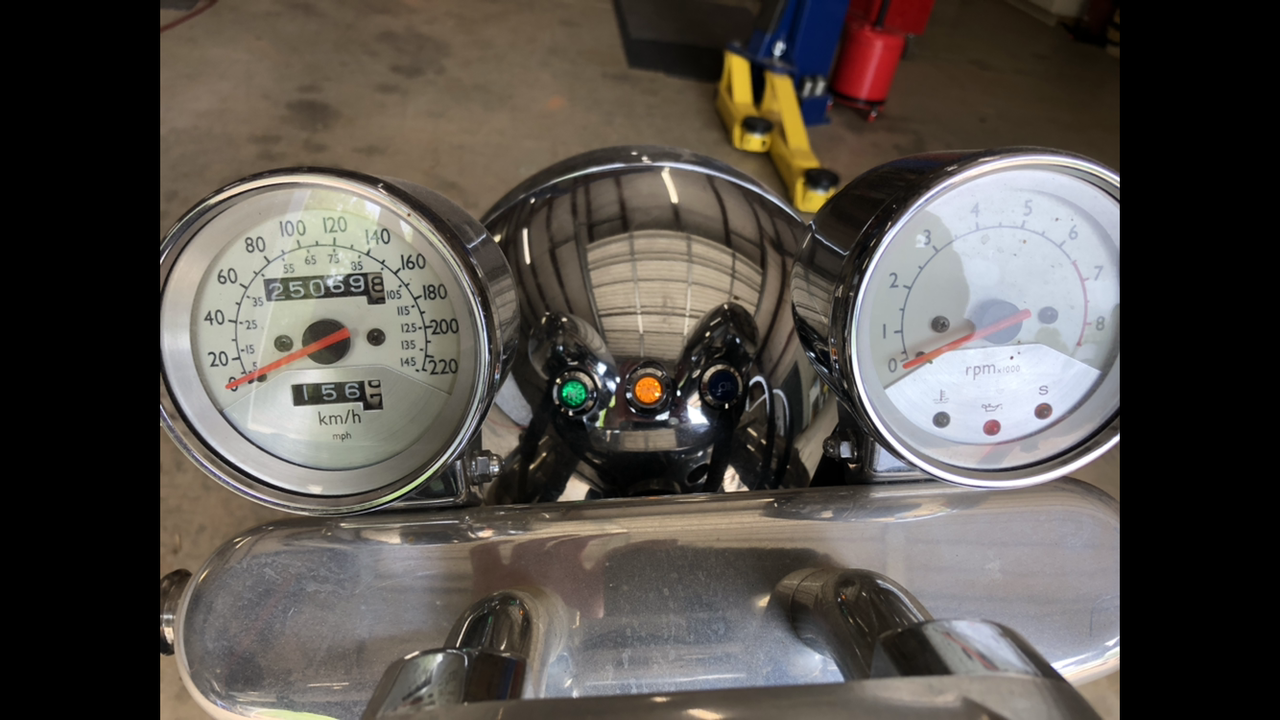

Problem:
One of these two things will occur
1- right signals and indicator bulb light up and stay lit. They do however, turn off when activating the left turn signal, but will not flash when activating the right circuit
2- This is new as of today. I removed the headlamp and housing to ease wire access. Problem 1 above went away even  though nothing was "fixed." In fact for the first few cycles everything worked fine  Now my new problem...after depressing the right signal button all of the right signals flash however so does my tsil light.

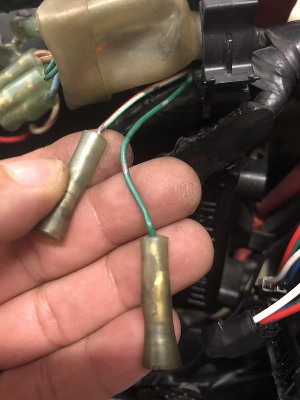

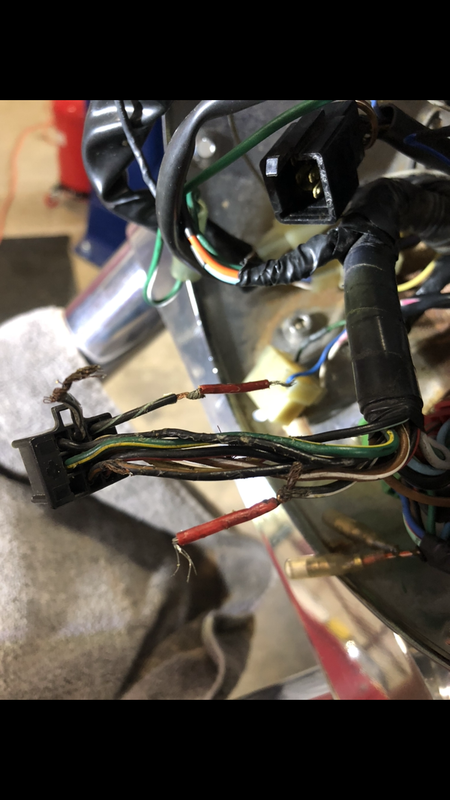

Here's the kinda stuff I keep finding in the headlamp, under right cover and even up near the hand controls.

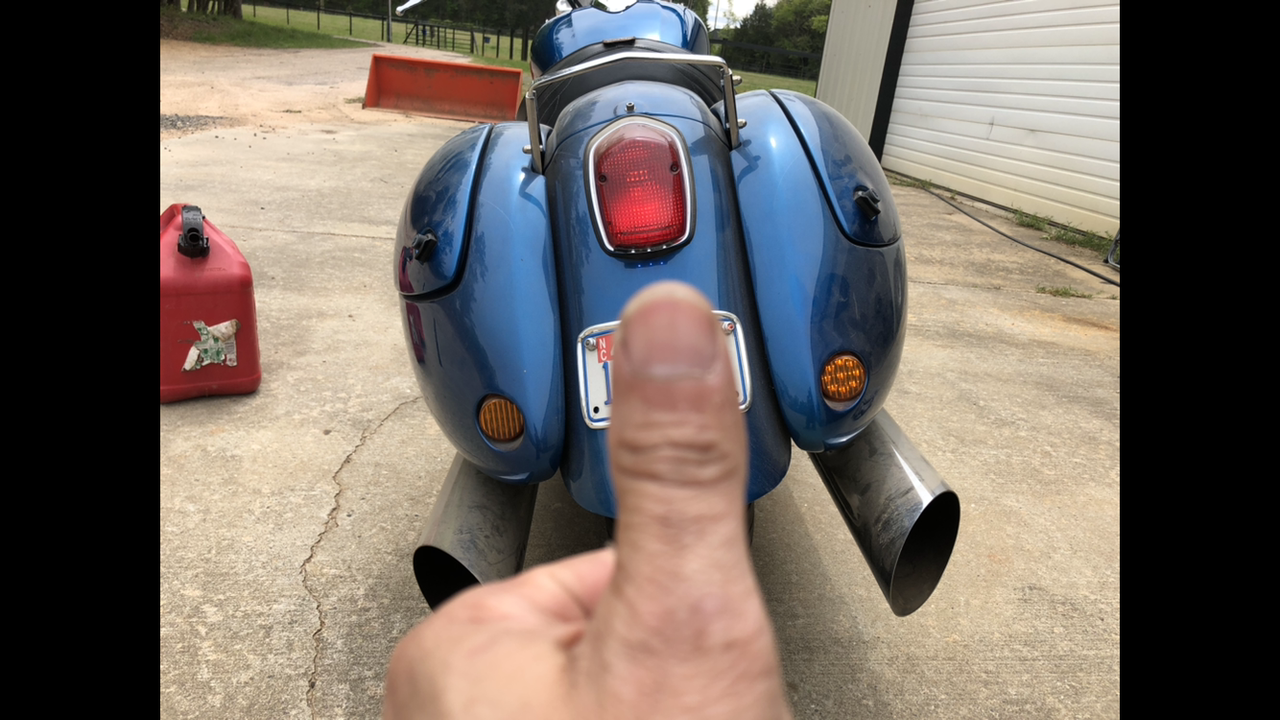

rafster
Posts: 45
Gastonia, NC
« Reply #5 on: April 29, 2018, 07:19:37 PM »

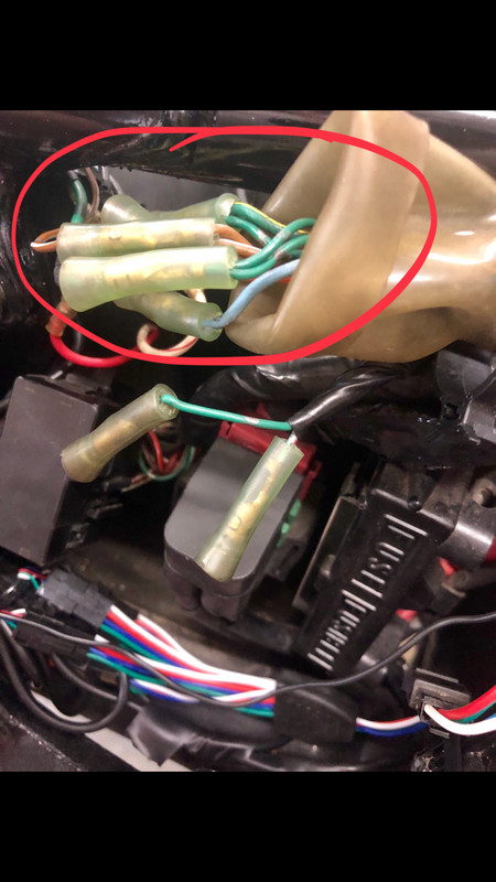

And this is what i see on the bike as well as what those behind me see.
Posts: 15373
« Reply #6 on: April 29, 2018, 07:29:57 PM »
That looks like one of the 9-pin connectors, one for each side of the handlebar controls. Someone as messed it up big time and if they're open like shown, then you're riding with a fire hazard in my opinion. You need to first make a diagram on a piece of paper of just where each color of wire goes in that connector....or all of them if they're like that. Then, sit down and start taking the connector apart, cut the wires back and crimp new pins on them, then reinsert according to your diagram. If you would go into your personal profile and list your city/location, there might be someone nearby willing to lend a hand. If you lived near Orlando, FL, I'd love to help. I have all kinds of connectors, pins, bullet connectors, etc., and know I can fix that. Just a couple hours in the shop is all it would take. Been there, done that....numerous times.  cooldude
rafster
Posts: 45
Gastonia, NC
« Reply #7 on: April 29, 2018, 07:47:49 PM »
Thanks a ton for the offer!  cooldude
You are correct.  Definite fire hazard.  I'm not riding with it like that. Well not anymore at least.   Clearly I rode like that for years unbeknownst to me.  I was just showing an example of what I keep finding.  I've fixed these and at least 5 more sections under the right cover in addition to two wires by the throttle. I know some will disagree, but I spliced, soldering and shrink wrapped everything.

« Reply #8 on: April 29, 2018, 07:57:17 PM »
FWIW whomever did those splices had done the twist and then cover with tape style of splicing. They then taped the entire group of wires together  I had no idea it was there until I unravelled the electrical tape!
I'm now wary of any electrical tape i find on the bike and have been on the hunt which is how I found the poor splices in those other locations.

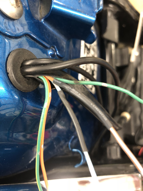

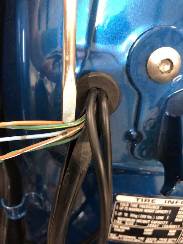

« Reply #27 on: May 19, 2018, 02:01:31 PM »
Gotta love how “life happens.”  Haven’t been able to work on the ol gal until today. Was rooting around and found these two wires with nothing attached.  One is a ground (more on that in a minute) & the other is a baby blue with red stripe that I can’t seem to find on the wiring diagram. I will say jarring them made my problem go away. Interestingly, when I run this green wire to a good ground all of my lights become more bright. I am definitely going to ground it, but I’m wondering - Does anyone knows where these are supposed to go?

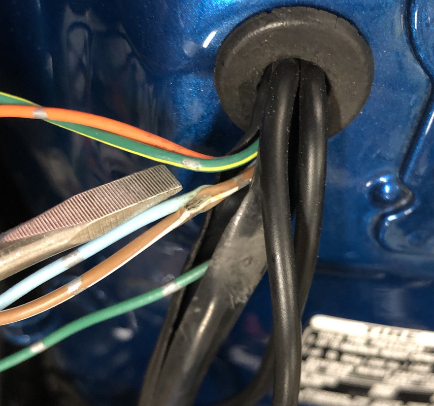

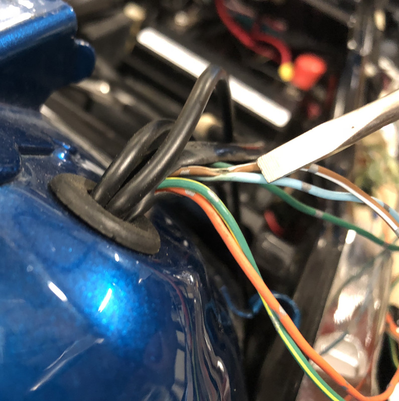

« Reply #28 on: May 19, 2018, 02:28:03 PM »
Here’s a little better view. By the way, this blue red wire is “keyed hot” and I do see a similar color and gauge wire going into the fuse box. About to lift the box to see which fuse it goes to.

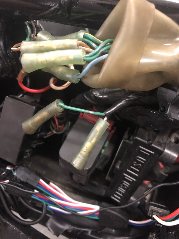

« Reply #29 on: May 19, 2018, 02:36:59 PM »
Well, the similar color wire feeds the accessory terminal at the fuse box. Pulling the fuse pulls power to my “spare” wire so I’m thinking these two wires are meant to be for an accessory protected by a 5A circuit.
So not I’m thinking I just got lucky today. I haven’t been able to replicate my right light circuit “on” problem. It’s happenee in the past. Heck I once even went about 6m without an issue. Starting to think moving things around was he biggest help today. Oh well. I can at least pass inspection and I am not willing to replace the entire circuit at this point.

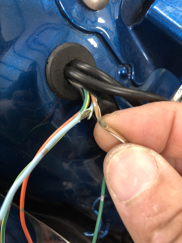

« Reply #30 on: May 19, 2018, 03:39:23 PM »
Well...I know how long it lasted. 30minutes to be exact. On the upside I now know exactly where the problem is located. Umm more or less. When moving around these wires I can trigger the problem and then make it go away.  Haven’t quite figured out if it’s a bad green ground wire connection or the blue wire to the turn signal circuit. On any case this is definite progress!
 I have half the mind to just insulate them all individually with electrical tape.  uglystupid2
rafster
Posts: 45
Gastonia, NC

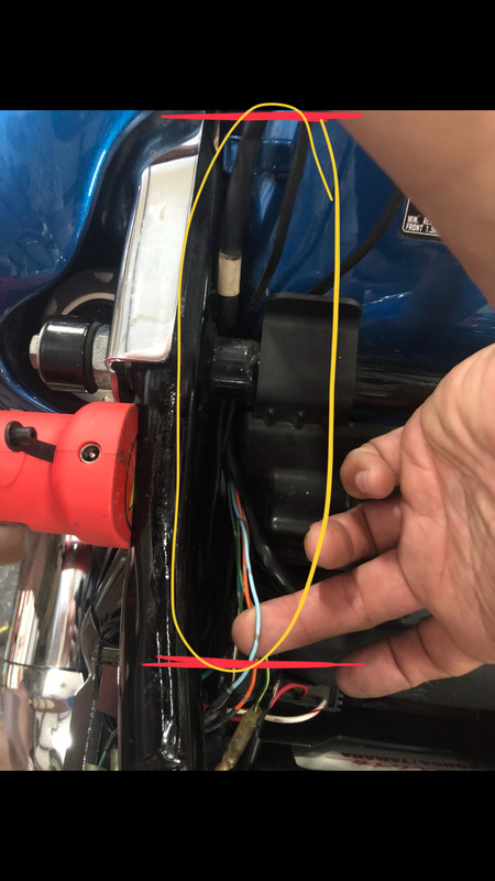

« Reply #31 on: May 19, 2018, 04:01:51 PM »
I kept jiggling and chasing. I was holding certain sections still while jiggling others and... EUREKA!!
I have narrowed the problem to this section! Holding between the two areas in red and moving my blue wire will “activate” and “fix” my problem. I’m stoked as I now know for certain there is a short in this section! I suspect it’s at the point where the body clip holds down the wiring. I’m just bummed that a prior commitment is making me pack it up for the night. I’ll post tomorrow once I find the culprit and make the repair. Keeping my fingers crossed!

I believe that cluster of wire under the cover are the ones for your rear turn signals/running lights. Also the brake for a std/tourer. Basically that is wire harness rear sub A, connected to sub B.
Grounding the extra green wire, sounds like you are improving the ground condition. So I suspect that you have a bad ground further down the line. It might be worth cleaning/adding some ground connectors.
rafster
Posts: 45
Gastonia, NC
« Reply #34 on: May 19, 2018, 06:50:37 PM »
It was 3 years old when I got it in 2000.
My theory is the short was there from the factory because the section where I've narrowed the problem to lies within the factory plastic shielding. I know the short has been there as long as I've owned the bike though its always been an intermittent problem.  Plus I get the sense someone tried to track it down previously. This would at least explain all of the random splices and exposed wires I previously fixed. The locations of these all coincide with places one would look to narrow down the problem and perhaps run tests.
I'm cautiously optimistic, but this is the first time I've been able to routinely replicate the problem. I mean its almost like flipping a switch soI know for a fact I have a problem within the section outlined above. What I don't know is whether or not it's the ONLY problem.  Hopefully tomorrow proves successful.
rafster
Posts: 45
Gastonia, NC
« Reply #35 on: May 19, 2018, 06:52:51 PM »
Great points! I will certainly double check everything in the morning. I will be a ground chasing fiend after I find and repair the short.

Well fellow Valksters here it is. The problem identified and the repair. Somehow the blue (right) turn signal wire and the brown/white brake wires were pinched. Not sure how it happened, but I am sure it is fixed. I was pleased to find both wires in relatively good condition with no frays. As you can see from the images I elected to just insulate them.
« Reply #39 on: May 20, 2018, 07:42:23 AM »
 cooldude good job. I would look at your seat pan and see if there is something that is pinching them. It's probably fine, looks like it happened long ago. But you don't want to go thru it again.  cooldude
