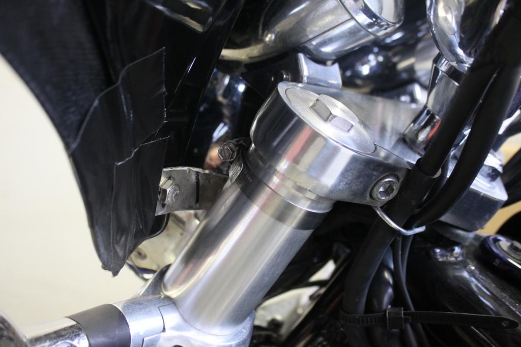

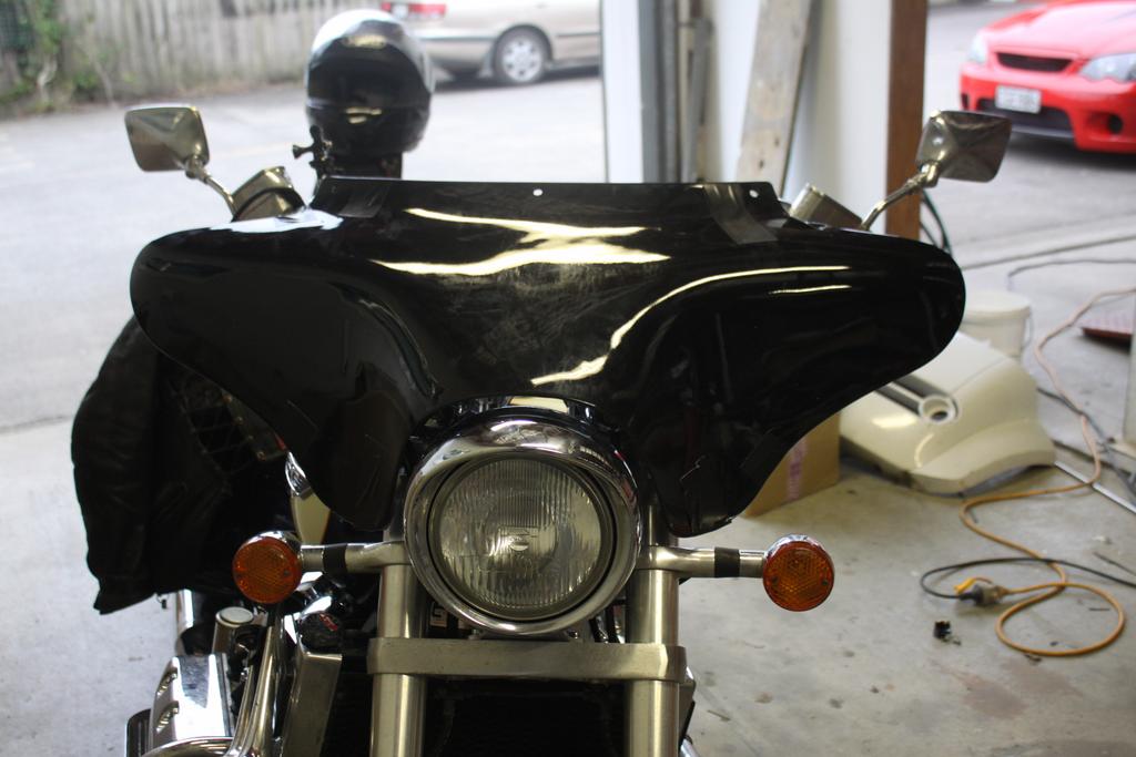

I received my fairing Yesterday so did a rough duck tape and packer fit up.....I think that is the angle/height I will end up fitting it, Bit cold here now with frosts the last 3 days so it will be nice to get out of the wind chill factor a little more... I will make it easy to remove for summer

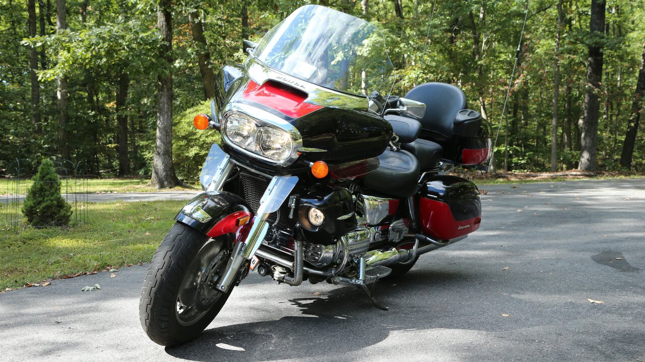

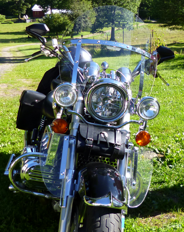

For more cold protection, you might look at some interstate pictures showing the fairing bottom (turning clearance unimpeded) air wings, and fork wings.  For air coming up under the fairing and bars.
Some windshield makers sell fork wings that may be somewhat universal (and can be home made too, though valk forks are fat ones).
But I've never been a fan of wind blockers on the hand grips.  Good gloves work.
Also, most of the shields that fit on batwings are pretty narrow (and short). I'd be looking for a shield that mounted up on the four standard screws, but got at least 2-4" wider on each side, as soon as it clears the screw mounts (above the fairing).
The shield on that interstate is afteramrket, wider on each side than stock.

One of those euro flip screens might work well for you. On my standard, I found the fork mounted lowers helped with the helmet buffeting I was getting with my Memphis Shades screen.

As far as the fork lowers, in my opinion the helmet buffeting situation is really the only thing they are good for.  cooldude

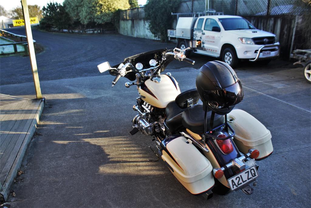

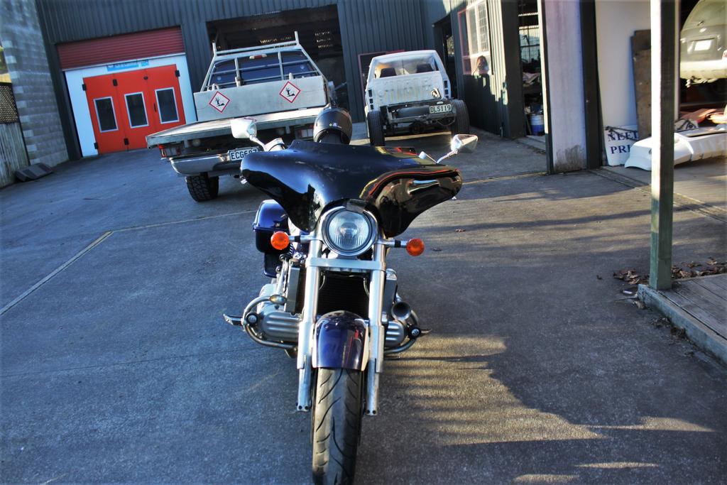

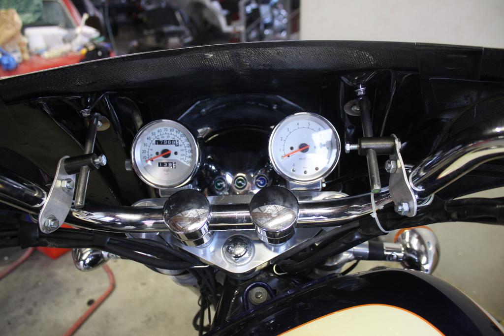

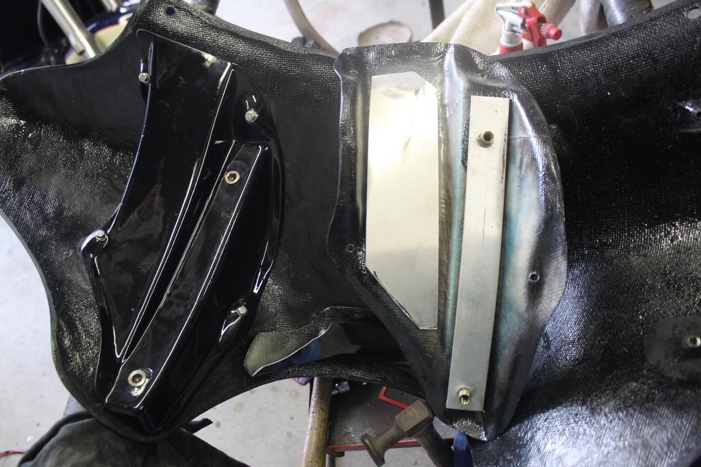

I grabbed a couple of U bolts to mount the fearing to the bars for now so I can do a test run, made some rough bottom brackets, fitted some alloy straps behind the F/Glass to rivnut too and mounted the fearing and took it for a ride (with some duct tape across the joint from the inner to outer....just is case the more chinese luggs break off that hold it together)
First run was better than expected, hands out of the wind 100%, Chest out of the wind with no screen, the helmet is in the wind but with no turbulence, I don't mind that .... Gives a better sense of speed as I had a tendency to go to quick behind a screen on my last bike....and it was nowhere near as quick or smooth as the Valkyrie Tongue
I will pull it back off to secure the inner to outer better, then try a screen or two out of some scrap material and tidy the mounts after that (incase I need to mod/adjust brackets for the screen tuning)

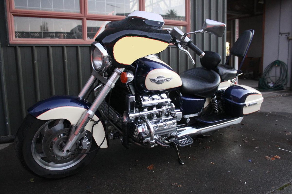

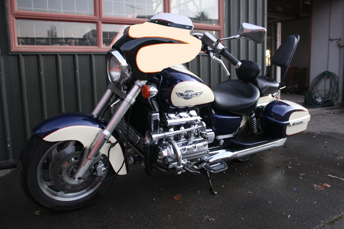

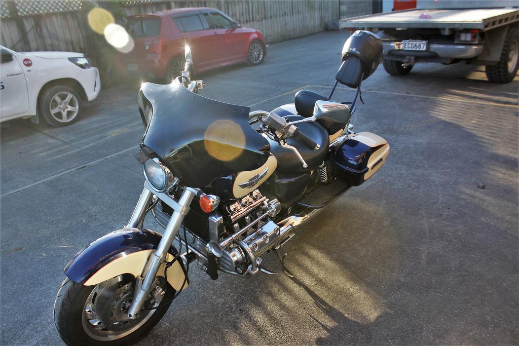

After some of your thoughts.... Top, middle or bottom pic better? or something different?
Both will be tweaked to when done as it was just a quick rough up Smiley

« Reply #14 on: June 16, 2018, 02:35:19 AM »
#2 for me  cooldude

« Reply #15 on: June 16, 2018, 10:04:25 PM »
#2 for me  cooldude
yup similar too number 2 is what I am thinking Smiley
not in that pic but I did make some wind defectors for the forks...it does make a difference with buffeting, I had higher screen but like having the wind so my preference is a very low screen still, I did run with 4 different heights
