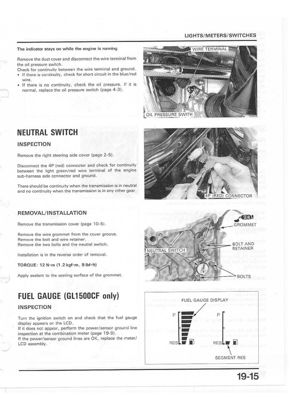

Not to highjack jc’s post, but I’m having a problem with my switch also. Where is the neutral switch, mine works sometimes. Can it be cleaned or should I just replace.
My second plug for Dag's website today. Download the 450 page shop manual for free here.
Don't know about cleaning versus replacement.
