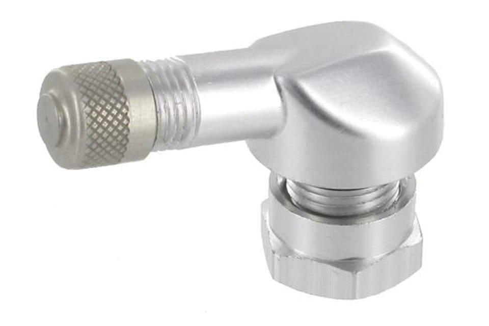

I have owned many motorcycles over the years but this is the first one that had valve stems with a 90 degree angle.  The other day while checking the tire pressure the little clip that looks like it is there to support the stem broke off.  Being I have never seem this before I have no idea where to find such a thing or even what it would be called.  It is not affecting function of the bike other then when I check the tire pressure.  I can't imagine this piece being more then a few dollars I just need so advise as to where to buy it.
Thanks in advance I'm sure someone will know what I'm talking about.

If you have replaced the stem with a metal one you should not need it. OEM was soft rubber stem

Do not remove the tire. just get a 8/10 inch c clamp and a block of wood, let the air out and clamp the tire bead to the left and replace the stem.
Posts: 30977
« Reply #6 on: June 23, 2018, 02:59:06 PM »
The support elbows are a workaround for chronically failing rubber stems.
They mostly fail from age and people punching on air gauges and air chucks without using the other hand to support the stem.  The stems crack at the wheel, with or without the elbows.  Even adding both new stems and elbows at every tire change is no guarantee of a safe valve stem.
A good number of folks have had traumatic failures with the stem blowing out of the wheel and immediate air loss.
Friends don't let friends continue to use the Valk valve stems.
Buy some metal stems and make your bike safe.
There are dozens of threads on here with the recommended stems.
They can be changed with the tire on the wheel with one or two big C clamps.

The thing you seek is a HOLDER, RIM VALVE - 42754-MN5-000 - $3.61
Your dealer can get one, or you can order one online, just google
that part number to find places that want to sell it to you...

As someone who has had a front tire valve stem fail at 65 mph speed I can tell you
CHANGE TO METAL STEMS before your next ride

METAL VALVE STEMS ONLY BE SAFE https://www.jpcycles.com/product/164-338/show-chrome-accessories-90-nickel-valve-stem?mrkgcl=444&mrkgadid=1330272401&utm_source=google&utm_medium=cpc&utm_term=75903095050product_type_l1vehicles_%26_parts%26product_type_l2land_vehicles%26product_type_l3mot&utm_campaign=PLA+-+Shopping+Campaign&product_id=164-338&utm_content=pla&adpos=1o2&creative=42616826650&device=c&matchtype=&network=g&gclid=EAIaIQobChMI36Pmxpnr2wIVA7bACh24xw17EAQYAiABEgKH7vD_BwE

This said I just check and the stems have clearly been replace with new metal or aluminum stems.  Do these still need the supports to be safe or is it OK to ride without them at least until they get here I have already ordered them either way.
« Reply #14 on: June 24, 2018, 09:17:32 AM »
The OEM ones are rubber and metal. They should be replaced in my opinion. With something like this.

Yes I would still install the supports as it take strain off the rubber washer used on the all metal stems.

Could be, the seal on the inside of the rim has the pressure of the nut and seal on the outside and the pressure of the air inside to seal. The air pressure should be enough to effect the seal, of course if no air the nut retains and seals, so both are necessary. Snug should be tight enough to seal with no air, my guess is that over tightening (compression) may shorten the life of the seal. The seals are not crush washers so over tightening may hasten splitting and cracks, but if you are replacing them with every tire change, probably does not cause an issue.
The strain I was referring to was when filling/checking air and at extreme high speeds when the force on the valve is most likely to cause movement and the Honda piece would serve to minimize movement in both cases.
The nut is also the retainer for the outside seal.
I would not loosen after over tightening as it may induce a slow leak.

The difference between OEM and the Patchboy stems which I use is the that full metal stem is one metal tube from end to end.  The rubber is only a gasket.  The OEM support wouldn't hold the stem tightly enough to avoid whatever tiny movement would result from compressing a properly snugged gasket.

I use these, and cut the ugly support studs off.  (They lay flat on the wheel, and to aim them to the right/high side of the bike,  you must cut them off or they won't fit in the wheel)
I won't be worrying about any flexion, for 25 years or so.  Smiley
Couldn't find a Valk/Wing mount pic.

« Reply #28 on: June 30, 2018, 04:42:52 AM »
Nice looking units, first I have seen of them.
Expecting 25 year life, great but you may want to consider replacing the core occasionally, if it has a soft seal.
From the picture it appears to be metal to metal contact when mounting to the wheel?
Is the nut a self locking, nylock or just plain thread?
Inquiring minds would like to know, thanks.
Posts: 30977
« Reply #29 on: June 30, 2018, 08:01:59 AM »
There's a gasket in there (just not visible in the pic).
Not sure of the self locking thing.
Here is a link to the mfr.
(Note, the same stems appear to be for sale for cheaper many other places. The way to tell is to look at the stamp on the side of the Motorcycle Anchor stem, then see if the same stamp is on the add for the cheaper stem.) (some are letters and some numbers, maybe year) (I just bought from the Mfgr)
Best stems bar none.  (I may change a Shrader, if it needs changing.  The aluminum caps also have Orings inside.)
Scroll down to see note for 1988-2000 Honda GL1500 GoldWing, and same deal/wheels for all Valks.
http://www.motorcycleanchor.com/tire_valves/
Or maybe:  https://www.revzilla.com/motorcycle/bike-master-90-degree-valve-stems
                  https://www.jpcycles.com/product/922-721/bikemaster-silver-11-3mm-angled-aluminum-valve-stem
« Last Edit: June 30, 2018, 08:04:34 AM by Jess from VA » Logged
Pete
Posts: 2673
« Reply #30 on: June 30, 2018, 08:09:45 AM »
Great info, thanks for posting it.
The first site says it has anti vibration sealant applied to the threads.
Nut torque to 7.2 lb-ft. DO NOT OVERTORQUE!
It also says the EPDM seal has a life minimum of 10 years.
Site suggests Shrader valve replacement after a decade, if it leaks.
Appears these folks have a superior product, worth looking at.
« Last Edit: June 30, 2018, 08:35:00 AM by Pete » Logged
Posts: 30977
« Reply #31 on: June 30, 2018, 08:48:20 AM »
Appears these folks have a superior product.
I thought so, and got them for both bikes.
Tires (wheels/stems) are only the single most important safety feature on any motorcycle, so $30 a pair didn't put me off.
No more kneeling down to make sure you hold the back of the stem punching on air or gauge either.  They are rock solid.  (The valves and metal caps are very finely threaded, so care must be exercised not to cross thread. Unlike plastic caps.)

Those aluminum valve stems are also available in colors.  Here is a red one I used on my old F6B.  They are available from HDL and others for about $4 each.  I think they are sourced from K&L.

You do not have to grind off the Ts if you orient those stems (point them) to the left-low side (they essentially lay flat on the rims).  No big deal on the front, but a big PITA with tourers and interstates in the back (where, unless you get the tire/stem just right to work from the back, you have to lay flat on your belly under the low side bag to get to the stem).
But, there is absolutely no reason to ever return to stock in getting rid of that designed to fail system with rubber stems and elbows.  Mine are cut off, and I would never go back to stock, and if I sell, neither can the new owner (and I've done him a big favor).
