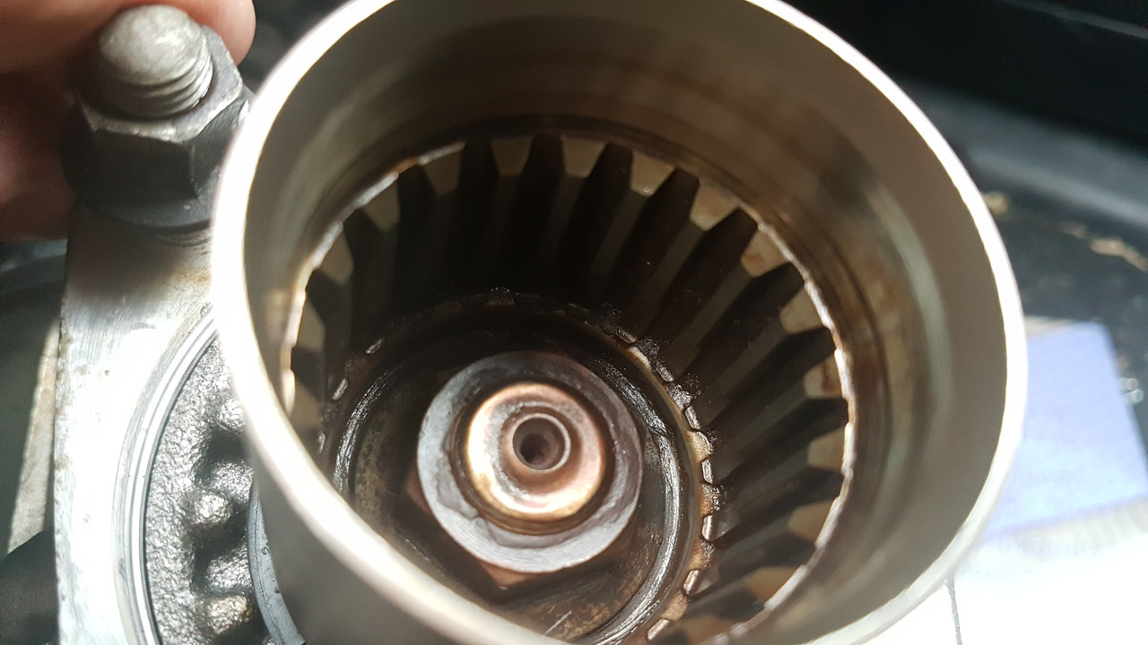

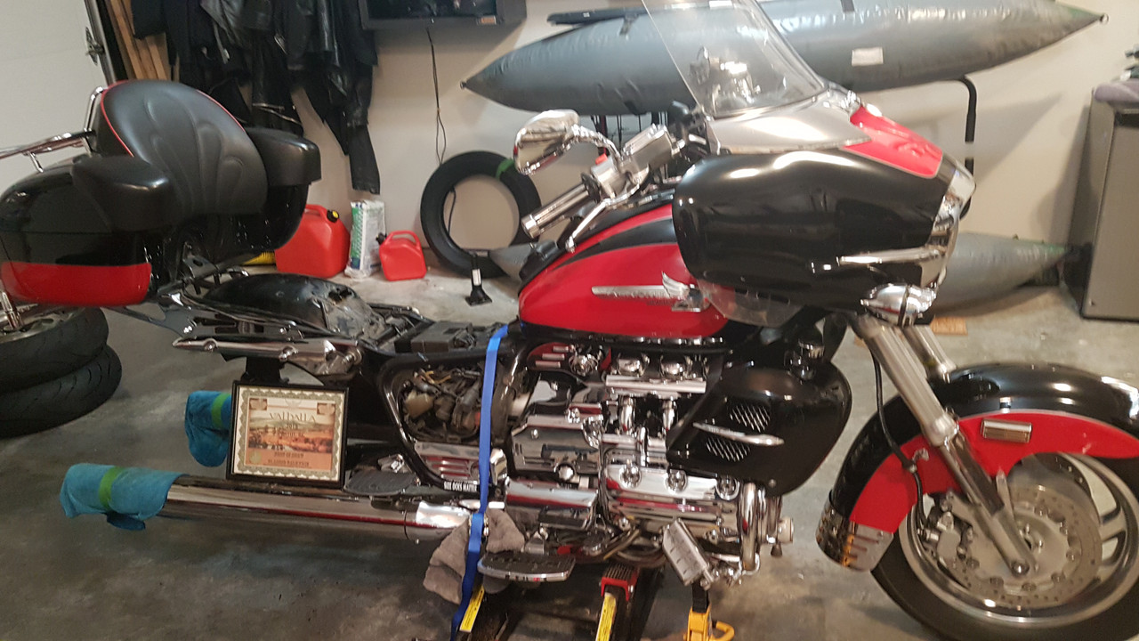

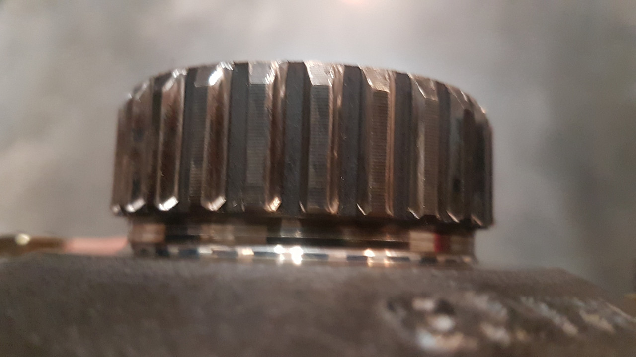

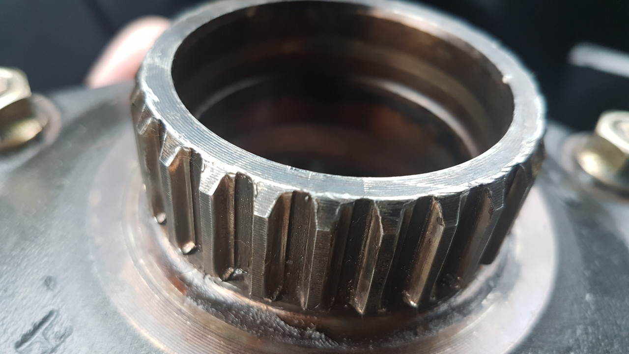

Found an issue with my final drive splines when I pulled her apart to change out the tire and do the rear end service, upon returning home from Valhalla. So, she's still up on the jack waiting for me to come up with a solution. My preferred option is to try and find a complete drive unit in good shape (my shaft and wheel flange splines are still good), so I was wondering if any of my Vermin friends might have one laying around or know where one might be?

No, the pinion cup is OK,
... it's the ring gear splines that are excessively worn.
The wheel flange splines are decent and I have a new spare one as well.
Finding a decent complete drive unit is the easiest and quickest solution...if that doesn't work out then I will look at purchasing the components necessary to rebuild new.

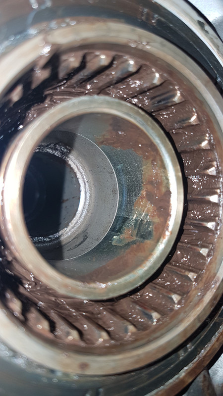

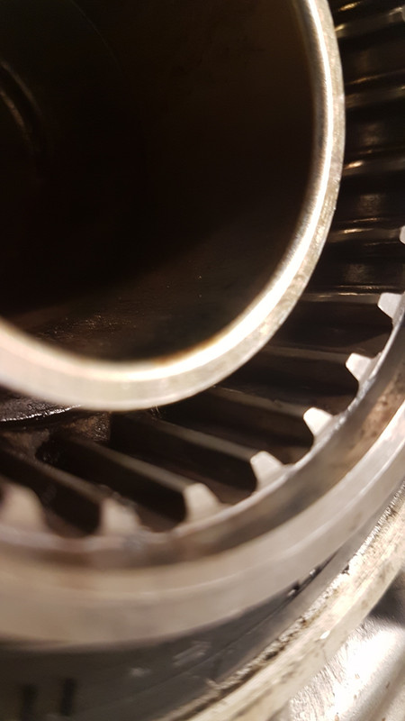

« Reply #6 on: July 11, 2018, 11:17:43 AM »
 After seeing the pictures  if it was my bike I would  put it back together and ride it. I wouldn't want to drag race it but should get you through the season. Was it noisy or vibrating or growling before you took it apart? All those splines are supported by bearings and the axle to keep them concentric. Keep an eye open for a used final drive and change it out this winter. I have a spare drive that I bought years ago that needs rebuilding for the same issue.  You can use it to rebuild  with new parts for installation on your bike for less down time  if you want. I would want your old drive once you change it out.

« Reply #9 on: July 12, 2018, 05:27:22 AM »
Ive seen alot worse.......for the rest of this riding season I would grease it up put new seals in her and ride it like you stole it....seriously thats what I would do...  Raymond (Whooray) Hill
