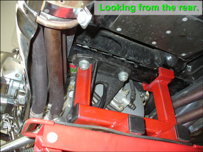

I need to change my shock bushings.  Is it safe to lift the Valk with a jack on the engine or do I need some sort of adapter?  I have an adapter that I bought years ago....never used it because it didn't fit properly/

Thanks for all the replies.  I bought a lift adapter about 15 years ago (forget who I bought it from but it is steel and painted red)  but I could never make it fit properly...….the left side support hit a bolt on the frame and the left side exhaust is in the way.  I like the low tech model.....should be able to whip one of those up pretty quickly.
  • the left side support hit a bolt on the frame and the left side exhaust is in the way.
The left support is suppose to be an angle iron and fit around the nut, if we're talking about the same thing. Dunno about the muffler issue.

That's the one I have.  It's almost as if the left side was welded out of position because I can't get it around that bolt no matter how I position it...…..pic to follow.
That upright is for line up purpose only. Doesnt take the weight of the bike any. I had a Valk that had a centerstand on it at one time. The centerstand had twisted the crosssmember some. Heavy bike on that stand. One reason for taking it off. Because the crossmeber was bent made upright not line up exact. I cut the angle upright off adapter. Worked just fine after that.
