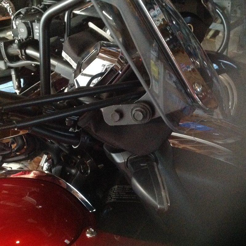

I have the Honda tall and here is a picture of the bracket that tilled the WS back.
The shield works great but I do look through it. I don't think I will cut it down I afraid it will cause buffing.

My extension is similar to Jack B but I used some 1" wide aluminum flat stock I got at Lowes years ago for a seat frame repair.  Mine is unpainted for now.

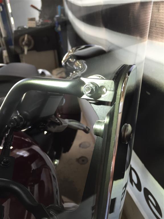

Brackets I made to be able to see over windshield.

Those brackets look great! How tall are you? Can you just barely see over the top?

Thanks, I'm 5' 7" and the windshield is 2 to 3 inches below my eyes. The wind at 75 mph is just hitting the top of the helmet which equates to almost no wind buffet, but allows some air into the top vents of my helmet.

I did try the 1" long bracket for the bottom of the shield to push it out and was just able to see over windshield. This allowed lots of air to get between the headlight and shield which had more buffeting than I wanted.
