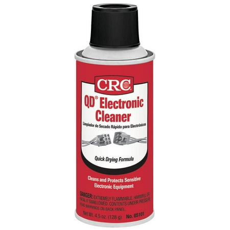

You know, I was commenting on not having had a bike flat for 40 years at Inzane-Roanoke, and damn if I didn't have a nail in my tire as I was all packed up to leave. (It never went flat, and didn't lose any air either (car tire) (and now repaired), but I think sometimes Karma is listening to things I say.

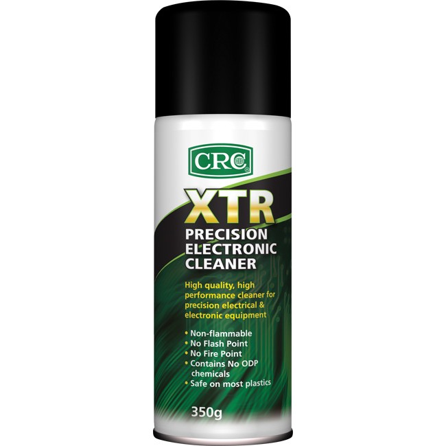

I have electronic cleaner/lube spray (used to be Radio Shack made good stuff.  If they still exist, I'd look for it again).  But there are others (CRC), etc.
I stick the little thin nozzle on and go around and hit my handlebar switches from time to time in the cracks (especially after a wet wash or rain ride).  I don't take anything apart (if I'm not having a problem), and there is some debate whether it gets into all the right places in all switches, but I do it anyway, from time to time.  Clutch and kickstand switches, lights, radio, signals, kill, ignition, locks.  It doesn't seem to hurt anything and doesn't leave any residue I can see, and I haven't had any switches get problematic (except my clutch switch needed blown out of crud a couple times).
I don't know if compressed air in a needle valve would be good or bad.  But it would blow crud out and around.
This is what I have used.

Jess from VA- thanks for responding to my post, and taking the time to post pictures of the products you use. I avoid riding in the rain like the plague! Most Radio Shacks in upstate New York have closed, but I am sure I can find switch lube/cleaner somewhere else.

While those are all great cleaners they are not really good corrosion inhibitors and unfortunately you need a corrosion inhibitor more. If you snap the switches a few times they clean themselves as long as they are not in terrible condition. Once cleaned they work well till the corrosion gets in again. The real problem is the switches really dont have any contacts, they just touch 2 pieces of metal together. Switches with contacts would not have this problem since the contact material could be made out of a metal that does not corrode.  The wires that go to the switches are so thin its pitiful and they are made poorly.
I wash my bike about once a week and go through rain once in awhile. It really doesn't matter if you do either though the metals that they make the switches out of corrode if you breath on them. So anything will get them to fail. If you spray a product like WD40 in there it is cleaner/protectant but it does wear off like I have said before. When I did it I would get about 1 month before they would have a problem again. Since spraying the CRC in the switches I have not had a problem for at least 8 months.
With this product it cleans enough to get the switches to work and lasts long enough to keep them working. I used this on outboard motors and it does hold up.
The switches are not sealed btw, they do not come separate from the switch housing though, maybe that is what they are talking about. So now you work the switch each time the bike starts but what about the headlight switch?
Bill
You have 2 switches on the handle bars one is the headlight High/low switch and the other is the kill switch. These are what we are talking about. The spot that is open is the kill switch.
« Last Edit: August 01, 2018, 04:27:55 PM by Robert » Logged
