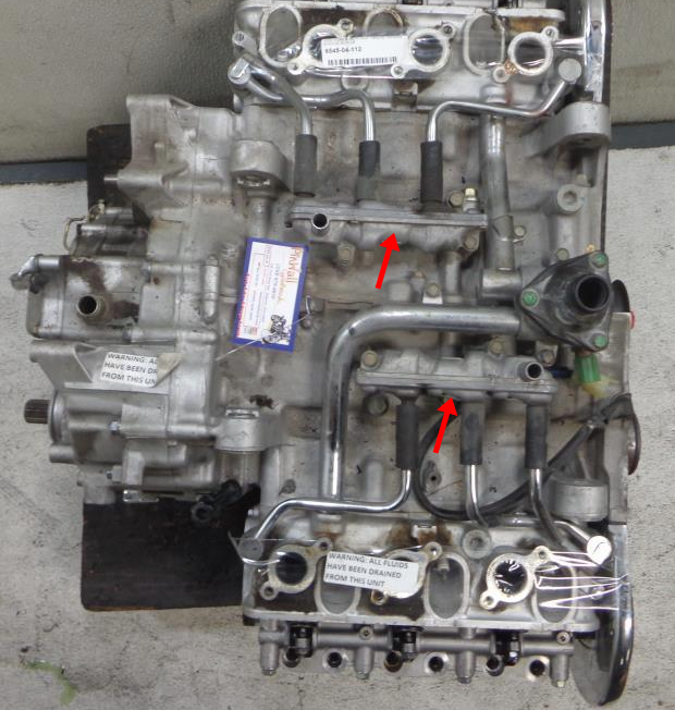

That's what I thought at first but if you look at the second picture, the air lines are still there and those are part of the list of parts that get removed during the de-smog.
I guess my next question is, is this what the vacuum hose looks like and broke off. Is that the nipple ?

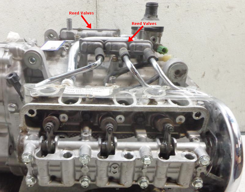

The easy desmog is to cap all your intake nipples , remove the read valves and plug the top of the chrome tubes. Leaving the tubes on the bike.  Oh except number 6 nipple which is a vacuum for the petcock if your have an OEM one. If you have a pingel petcock, then all intake nipples would be capped. I would redo all of them, which can be done with out pulling tank and airbox.
« Reply #6 on: August 11, 2018, 06:20:55 AM »
Some guys do a desmog leaving the chrome tubes in place. In your pic it looks like there is a metal bracket of some sort attached to the hose ?
You're talking about the first pic right ? Yea, that's what started all of this confusion. If that was just a vacuum line, it wouldn't have that black nipple or plug or whatever it is by my finger. That is why I thought it was de-smogged. Then I saw that not all of the parts that are normally taken off when doing the de-smog were taken off.
Not all of those vacuum hoses go straight to the carb, right ? They would go to part of the smog system ?
There are a few ways guys have done it. I prefer to remove all the stuff. I don’t see myself ever wanting it back on. Have you seen this in shoptalk ?

Yes, the 3 that are plugged already is how mother honda did it from the factory. It doesn't indicate a poor boy desmog has been done. Your idle symptoms indicate a failed vac line.

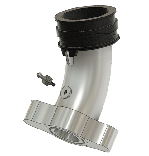

For reference, Intakes 1, 2 & 5 should have the plugs.  Intakes 3 & 4 have the pair valve tubing, and intake 6 is used for the vacuum petcock.
Your plugs on the intakes look like they are from redeyetech, but it’s hard for me to tell from the picture.  They could also be Honda OEM.  Redeyetech has had at least 5 different variations over the years in the search to perfect the plugs, and his latest version is the best.
The OEM plugs will crack over time and with heat exposure and need to be replaced.  The plugs you have are not part of any desmog attempt.  The redeyetech plugs are of a better material than rubber and will last a lot longer.  When the plugs deteriorate you will notice an intake leak.  Don’t try to use plain rubber plugs from the auto parts store as they don’t hold up very well.  If you get popping on deceleration, that can be enough to blow a plug off the nipple if it isn’t clipped securely.  I had this happen once with Cobra pipes and the air leakage from the missing plug made a lot of noise.
If you need to see the Honda reference, look at parts #24 and #6 in the diagram.  This shows the plugs and clip shown in your first picture.
https://www.bikebandit.com/oem-parts/1999-honda-valkyrie-gl1500c/o/m151390#sch613698
If your bike was desmogged you wouldn’t have pair valve tubing and the chromed tubing might have been removed depending on the full desmog...the lazy version leaves the chrome tubing in place.
You can replace the vacuum intake nipples with bolts, but save the nipples because you will need them for doing a carb synch.  You shouldn’t have to do carb synch very often so plugging them is an option.  I just use the redeyetech plugs.
