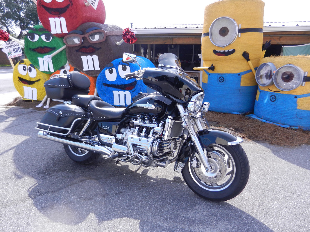

These Mustang Bags are mounted on modified OEM soft bag mounts and they are perfect

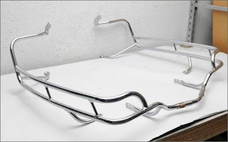

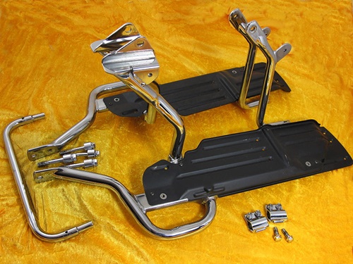

If you were to buy oem tourer bags you'd need this oem bracket for the tourer hardbags which cost a lot $$. The brackets support the tourer bags from the bottom and also provides a heat shield over the mufflers. Oem saddlebag *guard rails* wrap around the hardbags (second pic) and are a separate item. Try post a pic of the saddlebags brackets that you have.

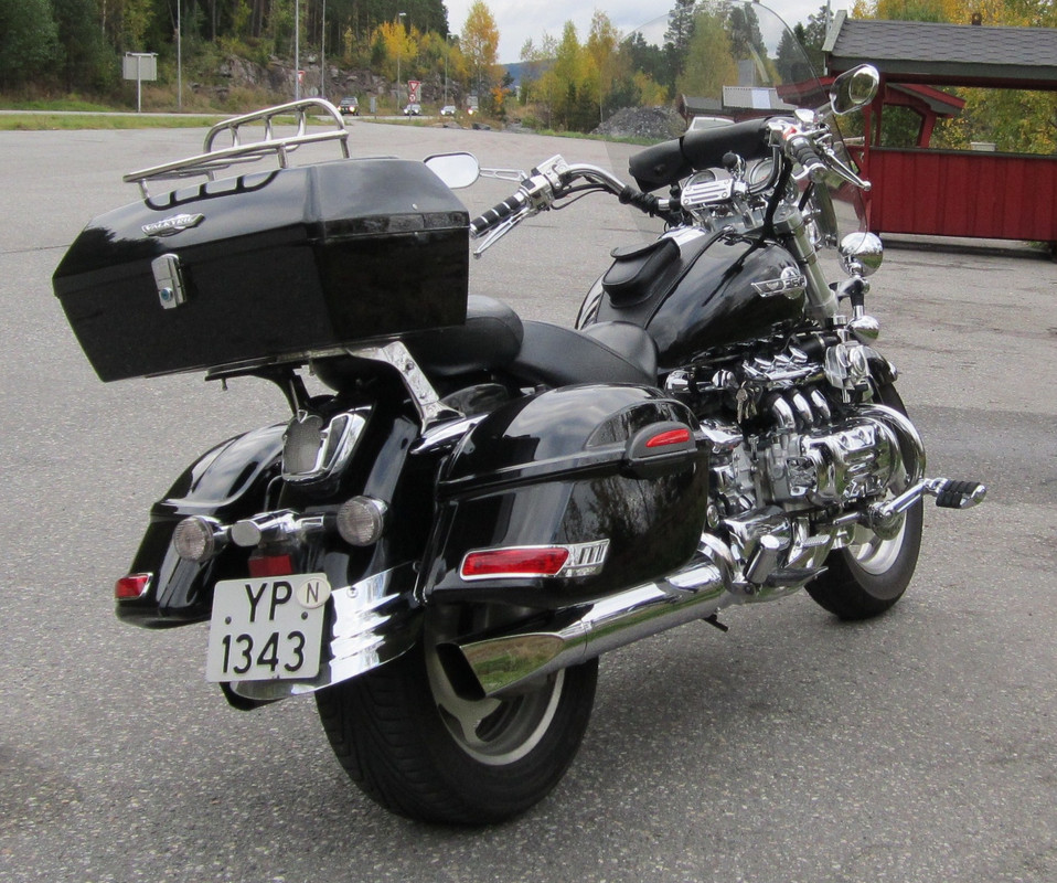

My Valk, standard with Matuza RS hardbags installed on the  mounts for the leather bag.
Easy connecting  lamp to funcion as both driving light and signal light.
The "old" mounts gave a much more steady installation than the ones following the Matuza bags.

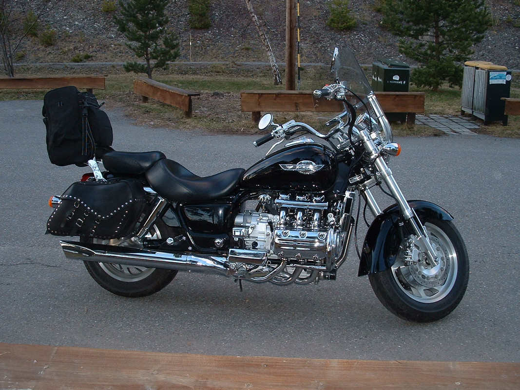

My Valk in 2005 with the leather bags
