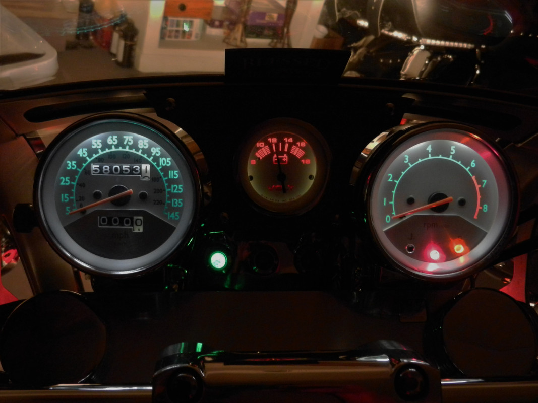

« Reply #11 on: August 31, 2018, 06:09:59 AM »
This is a shot from when I changed the meter lights to LED. You can see that the spot where where the temp light resides is all dark.
« Last Edit: August 31, 2018, 06:14:11 AM by Chrisj CMA » Logged

Turn the ignit~ons w~tchO N and check the indicator.
If the rnd~cator does not come on, replace the ndlcator
Unit
If the ~ndicarorc omes on, checkfor short circuit In the light
greenlblack wire between the tachometer 9P connector
and indicator unit 4P connector. If the llght green/black
wlre is OK, replace the tachometer assembly (page 19-7).
The Coolant Temp Indicator comes on for the IS with the ignition, not for the standard or tourer period, done.
