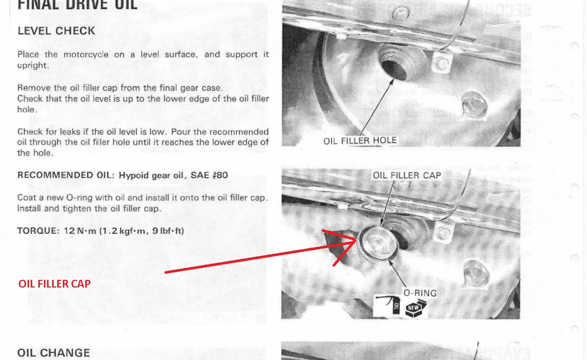

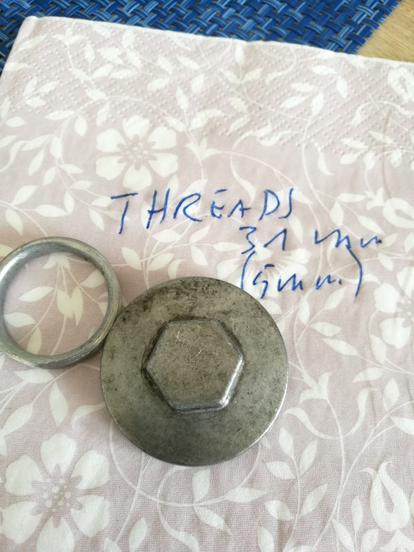

i've been stupid Sad Sad
Checked oil level, tighten a bit to hard after...oil filler  cap broken Angry Angry Sad Sad
Do Goldwings have such cap that will fit??
Over here (Norway) spares for the Valk is usually hard to find.

Still available at Honda Direct Line.
https://www.hondadirectline.com/index.htm
Search under "Final Driven Gear"  Its item no. 2  The o-ring is sold separately its #33
I would get the new o-ring.  Then you don't need to over tighten it just snug and the o-ring keeps it from leaking.

« Reply #2 on: September 02, 2018, 06:14:18 AM »
Not sure what part you are displaying but my cap as you describe/picture looks totally different. Part #1 and #16.
https://www.powershondaparts.com/oemparts/a/hon/506cb613f870023420a41728/rear-case
As for the part you are displaying I've seen in other part fische seem to be the same as a GW.
Part #'s #10 & #9?
https://www.powershondaparts.com/oemparts/a/hon/506cb612f870023420a41723/transmission-cover
Posts: 14898
« Reply #3 on: September 02, 2018, 06:23:00 AM »
Part #'s #10 & #9?
The OP was checking the oil in the Final Drive  uglystupid2

« Reply #11 on: September 03, 2018, 01:44:31 AM »
 Smiley
I just got confirmed from a local  Honda bike shop this cap goes on more Honda bikes CB 750 and others' smaller, bigger ,older etc and they have a slightly different name from where they are placed ( They are not all on the final driven gear.)
1261-035-000 is the number for the Cap, tappet adjusting hole on my Valk.
Other numbers are
12361-300-000
12361371-980
O-RING # 91302-001-020 , diam 30,8 mm
I'll get it at my shop in 2-3 days.

« Reply #13 on: September 04, 2018, 04:17:43 AM »
same cap is used on cylinder head cover on the old Honda single camshaft models, CB 350, 500, 750
for valve inspection ! It is cheap and easy to get even here in europe!!
For part numbers you could check at cmsnl.com

« Reply #15 on: September 04, 2018, 06:40:39 PM »
I'm pretty sure that is not a standard metric thread.  I believe it is pipe thread.  If all else fails check with your local bolt house to see if they have a hex pipe plug.  I used one on my Shadow for a while.
« Reply #16 on: September 04, 2018, 07:03:53 PM »
I don't know, I haven't checked it out. But that would be the first non metric item that I'm aware of Honda using.
 This will likely get some heads spinning. But, quite some time back I did the same as the OP and cracked it by over tightening it. I got a rubber stopper from Ace Hardware and screwd it in tight. Rode it for a week and 600 miles while waiting for the replacement in the mail. Never leaked a drop.
Redline +
Posts: 513
Northwest Washington
« Reply #17 on: September 04, 2018, 09:56:02 PM »
Please don’t do this, these are straight threads with an o-ring, NOT tapered pipe threads.
