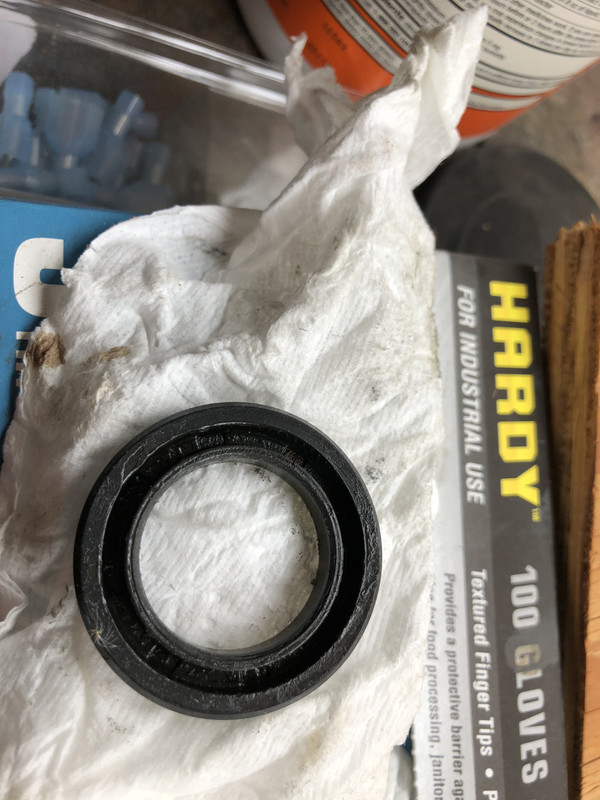

I have a possibly "dumb" question. When I took the drive shaft apart, the oil seal was loose. It looked to me that it might be in backwards. The beveled end was towards the u-joint side. Is that the way it goes? Looks to me like the beveled side should go towards the pinion cup.  Undecided
Once inserted you should see flat not the groove and the spring
Thanks Chris, but I'm still confused. The seal goes into the pinion cup, right? The spring is on the u-joint side. Which way does the beveled side go?
The spring that is part of the seal faces the rear.
windows screen capture
This side is going to face the ujoint.
how to do a screen shot
This side is going to face the pinion cup.

Thanks guys! Mine was in backwards! Might have contributed to the failure. I have to plead ignorance though, I thought that end of the drive shaft was lubed by the oil in the pumpkin.  uglystupid2 It was a dry rusty mess.  Undecided
