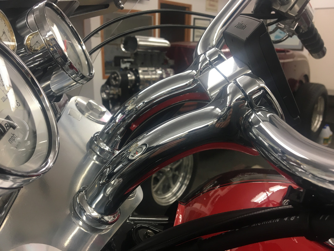

Harley Davidson Deuce risers are a good option for the Valkyrie. I can't speak for the aftermarket knock-offs, I choose to use genuine HD risers on my 2002 Standard.
The HD risers are not a direct bolt-on, Harley uses a counterbore in the top clamp and the risers have a step in the base that locates in this counterbore. This step needs to be removed to mount on a Valkyrie. The bolt holes in the top clamp also need to be enlarged slightly. With some fiddling, the wiring length is OK, hose lengths are OK, I did install longer throttle cables and an Interstate housing for a cleaner install.
The Deuce risers made a big difference for me, bringing the bars back so I'm not reaching for them, reducing shoulder and back fatigue.

I have genuine Deuce risers on my Valk, they were one of the best things that I have done to my Valk, the bars are now in a more comfortable position. As to cables you can re-route them or alternatively as I have done get an IS throttle boss (Pinwall) and as the cables exit down instead of forward you can easily keep standard cables and routing.
You can see the Interstate throttle housing installed on the Standard pictured above.

I have the HD Deuce risers too.  (I don't know if they are OE or aftermarket)
They are 5.5", rather than the more usual 4" aftermarket risers (Valk OE risers are 3 1/8")
As mentioned, the domes on the bottom of these risers need ground flat, reroute cables behind the triple tree (or go to interstate throttle housings), and either drill out a few thousandths of material from the riser holes in the tree, or buy these riser conversion bolts (SAE to metric).
https://www.baronscustom.com/catalog/display/1182/index.html
http://www.phatperformanceparts.com/LA_Choppers_Handlebar_Risers_Mounting_Bolts_1_2_p/lac-risers-studs.htm
If you drill out the holes (to 1/2"), only a slight bit of material is shaved, and you can always go back to metric with no loss of function.
On the other hand, these 4" risers require no mods of any kind (at least on interstates with interstate throttle housings). I have them on my other Valk.
https://www.aeromachmfg.com/RISER_SET_4_VTX_Retro_1300_p/am-4120c.htm
Or, go with one inch riser spacers for metric bikes with one inch handlebars. (cheapest)
I'm also 5'9".  I prefer the 4" risers for cranking and banking and the 5.5" risers for kicked back cruising.  Note the 5.5" risers at full lock turns put the bar ends/your hands close to your thighs.  Not touching, but close.
No one has reported deuce risers (original HD or aftermarket) ever breaking.   These 4" aftermarket riser top clamps have cracked through to the bolts.

I have the same risers as Redline on Jade.  I re-routed the throttle cables aft of the triple tree and rotated the bars down so my wrists are straight.  This helps a lot for comfort and dealing with carpal-tunnel and hand numbness.  I keep my handle bars low on all my bikes and learned long ago to move my knee out of the way for full-lock turns.  Easy to get in that habit; while full-lock turns generally only happen if needing to make a U-turn.  On Jade I have both a Brake-Away throttle lock and a Rostra electronic cruise control - handy mods for a long-distance cruiser.  Other relevent mods - a Russell seat, backrest and highway pegs with fwd controls - I'm 6ft with 31" inseam; don't reach for the bars.

Just my two cents from my experience with the cheap imports. I added risers to my Suzuki  C90 trike when I added a fairing. Not knowing exactly what rise and pullback I needed I went cheap. First the aluminum threads for the triple tree bolt stripped out. Then the knurling inside the handlebar clamps would not hold the bars up and tight. The style of risers I have do have smooth covers. I had to drill a tap for a set screw in each cap that now holds the bar in place without interfering with the covers. Maneuvering a trike does put more stress on the risers and they do twist in the rubber mounting of the triple tree on this C90. One more issue with these, in the trash bin they go. Now I understand why mother Honda put that solid cover on top of both risers. It stops the twisting.
Good luck.

For additional options, 2002-2007 VTX 1800C risers are 5" tall with 3" pullback but are $140 for a set.

I have these on my '97 Standard and really like them. No modifications required. The quality is top notch.
https://www.baronscustom.com/catalog/display/775/index.html
Good luck.
i was worried about the same thing with mine being a trike.
did'nt want to go into a turn hot and heavy only to have the risers break.
so i'm still using stock.
as far as the top bridge being solid. that definitely makes sense. i can see without the top bridge being solid the forces would try and twist the singles
