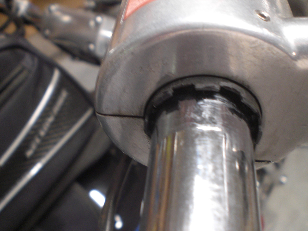

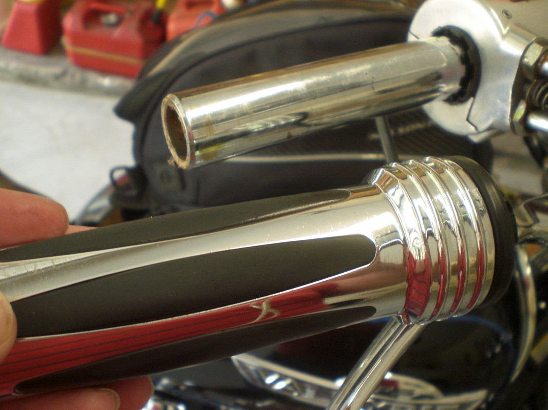

Be aware that this model can come apart in your right hand. The PO fitted them. I don't know how long ago nor how often they were used before I bought the bike.

Britman.  Did the tube break or does the throttle tube on those engage into the cable side half.
« Reply #4 on: October 12, 2018, 09:28:46 AM »
The notched part coming out of the clamp now fits into the notched part on the grip itself.
There is no separate tube. What looks like a tube inside the heated part is fixed in place. Can't be replaced. Have to fit a complete grip.
 The two pieces came apart. Unglued?

I ordered and received the show chrome grips.  Britman you are correct. Although they look good the throttle sleeve has a couple of issues.  The instructions suggest having the wiring out of the throttle grip facing down or forward but when installed with the cables on,  it faces toward the rear..I didn't like that so upon investigation at the tube the glue that was used was barely anything more than silicone. One small push with my thumb and it was off.  There are two wide indexing notches and quite a few small ones that are all the same.  One of the wide ones has an extra tang on it so I cut it off and was able to move the insert 180.  I used jb weld on it and held the grip together gently in the vice till it hardened overnight.  It now faces forward and is nice and secure,  far better than the supposed glue they used. I will finish today with a relay on the circuit.  Hope this helps someone in the future.
Warren
EDIT  be sure and use a bit of sandpaper on the mating surfaces to etch them.  In the small teeth cut outs I scraped a bit with a small exacto knife to mark the surface so the epoxy can bite and hold
