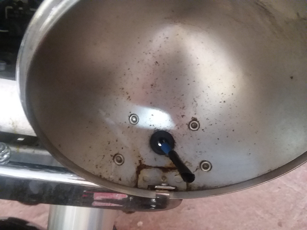

« Reply #19 on: November 07, 2018, 08:20:25 AM »
If I feed the earth back through the hole in the bucket and attach to bolt holding light to light bar that should earth the light?
Live wire in photo.

« Reply #20 on: November 07, 2018, 08:54:12 AM »
Yep

« Reply #22 on: November 07, 2018, 09:28:44 AM »
Just make sure the bolt and faces that bolt together are clean & Rust free or it may be enough to break the circuit Smiley
 Good luck
« Reply #23 on: November 07, 2018, 09:58:25 AM »
 Good luck

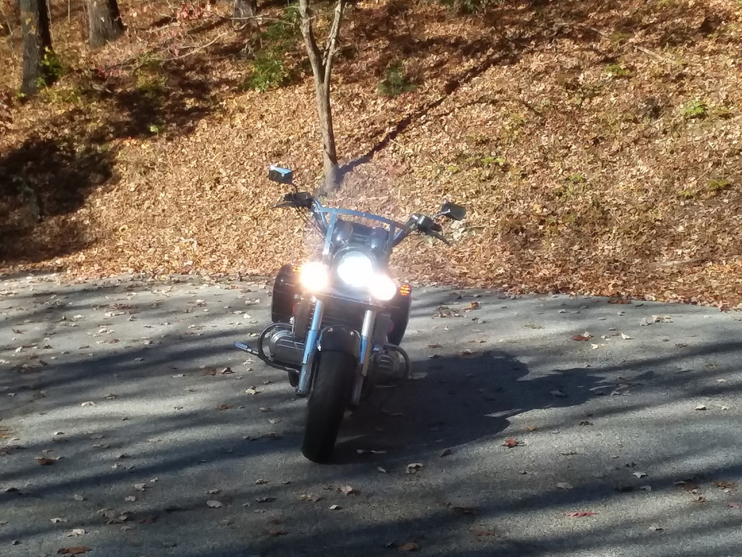

« Reply #26 on: November 11, 2018, 10:49:43 AM »
Et voilá, mesdames et messieurs.
Thanks to all for your help.
They are bright. I hope they are focused as well.

« Reply #28 on: November 11, 2018, 05:16:01 PM »
Put bike outside at dark to adjust lights and take photos and the heavens opened.
Will try again Tues night.
