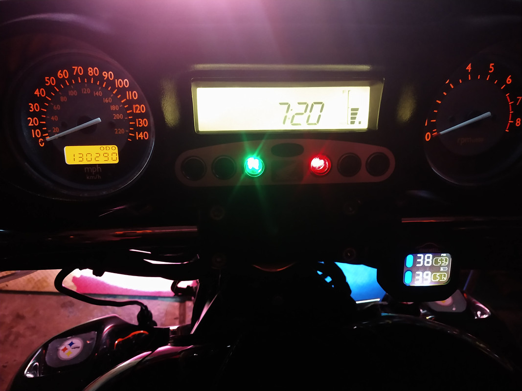

I had 2 burned out incandescent bulbs in my IS instrument cluster and it was very hard to read the gauges at night, so since it is snowing in MI, I ordered these
https://www.superbrightleds.com/moreinfo/instrument-cluster-gauge/74-led-bulb-3-smd-led-miniature-wedge-retrofit-car/228/1067/
 from superbright LEDs and replaced them.
Here is the result:
I used the cool 6500k white bulbs but they are available in other colors.

« Reply #1 on: November 10, 2018, 03:29:54 PM »
Looks good, maybe drill some 2 inch holes and put a couple behind the Steelers emblems on the pods..

« Reply #2 on: November 11, 2018, 06:16:43 PM »
Just to confirm, this was for the cluster lights (speed/tach), not the oil/stand lights?
I see you have the same TPMS I have too, still up and charged. How long so far since the first charge? I think mine was May. Around $63 CAD.
Correct, these are the Instrument Cluster bulbs.  If you install them and they don't light, turn the base 180* to reverse the polarity.  That TPS monitor was charged last in October, it seems to hold a charge well.  I just looked up the order, $52 on amazon.
