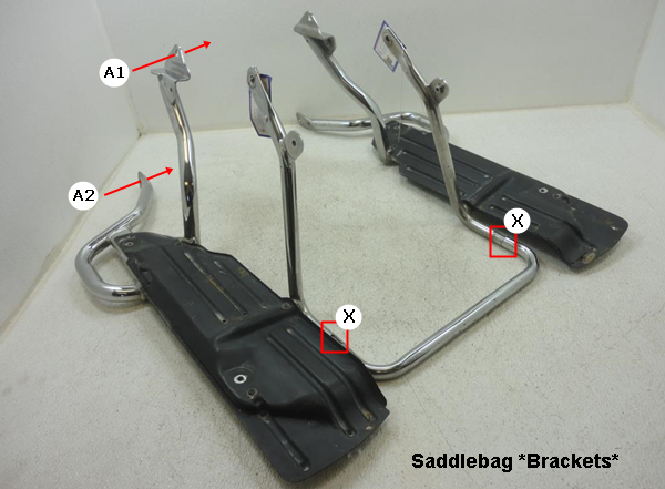

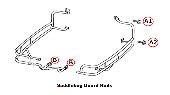

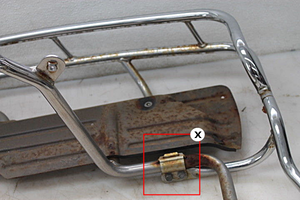

If you bought look-a-like Valk bags from tsukayu, the guard rails will probably fit. However, without oem saddlebag *brackets,* you'll have to improvise something to anchor Guard Rail B to keep the tail end of the guard rails from flopping around. The front of the guard rails are attached with Bolts A.
Guard Rail B (above) is clamped to the saddlebag brackets at X.
The clamp.

I have a question. If the stern of the guard rails aren't bolted down to something, doesn't the tail end of the guard rails flop around?
