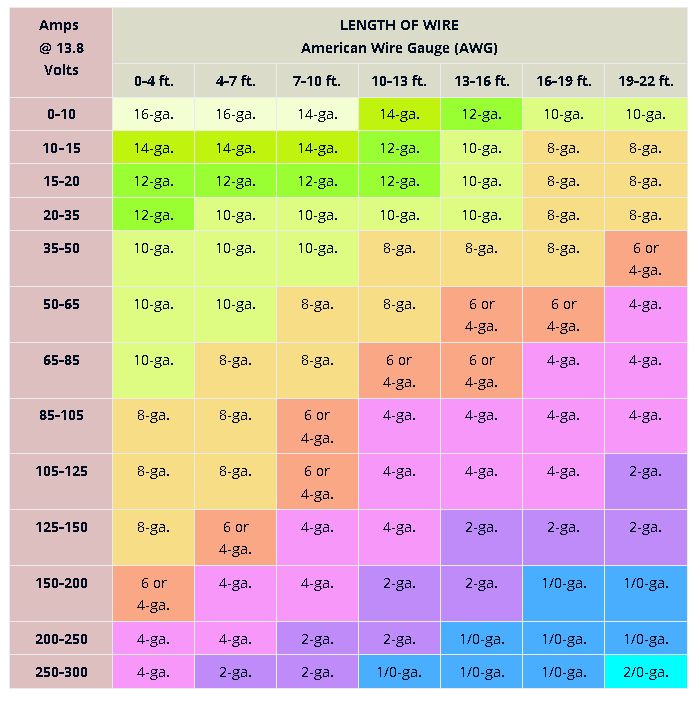

Mark, thanks for the useful idea.  I'll look at running a separate wire from battery minus to a frame piece nearby.  That would be "belt and suspenders".  No need for a real heavy wire if the run is short.  Connecting to aluminum is always "iffy".
I haven't checked the amps vs. gauge chart but as a SWAG I wouldn't go less than 8 gauge.  It has to carry cranking power.  Just moving the existing wire is easiest.
Speaking of that here's a table - from off-roaders.com:
