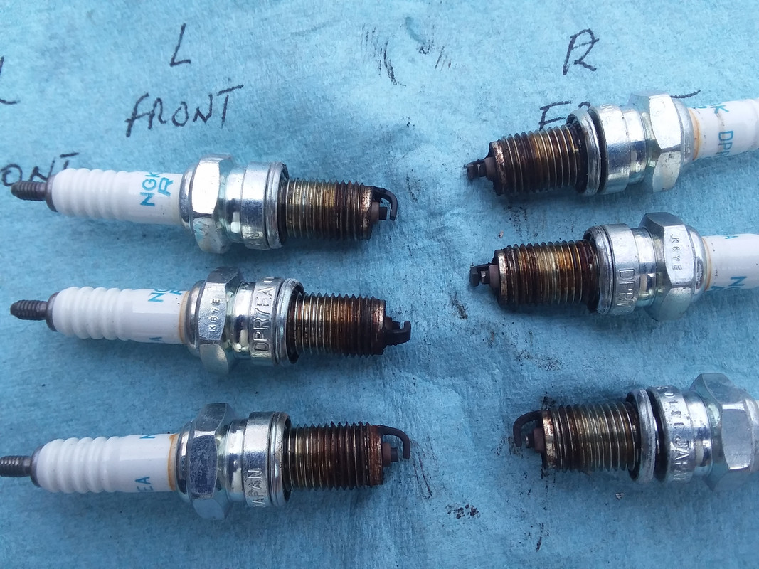

« Reply #11 on: March 31, 2019, 07:11:13 AM »
Popped out easy peasy.
I think they look pretty good.
I'll clean them and keep them as spares.
