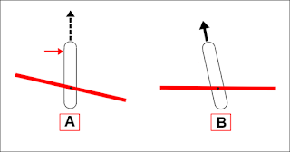

Seem to me like the triple clamps are pointed to the right a bit when cruising straight down the road. Bike has 50k miles , new tires and steering bearings, and wheel bearings. All work done by a 25 year Goldwing shop of good repute.
If your handlebars point to the right on a straight road (A, below), the front wheel is misaligned to the left if you were to hold the handlebars square to the length of the bike (B). To re-adjust handlebars pointed to the right, hit the front wheel to the right. Sounds counter-intuitive. Keep looking at B (below), and to square the wheel straight, you have to bang the wheel to the right to re-square a left pointed wheel, so on. Just bang the front wheel against a concrete column or a wall (bike angled to the wall). Gently and perhaps rotating the wheel, and avoid banging the rim. Might take several tries, or several road tests. [edit] I wouldn't loosen any bolts. You want to replicate things as they were when the wheel was misaligned.
