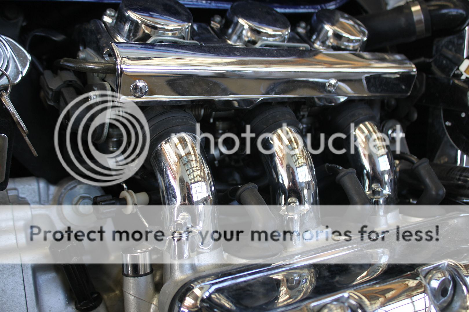

Well sure don;t know about the jet size yet....but there is NO foam in the air cleaner, it is pleated paper, I had to take the tank off to replace the radiator, so pulled the air cleaner and cleaned it.  It still had the original Honda green air cleaner.
Here she is partially cobbled together, and a pic of the sticker by the coolant reservoir showing the CX sticker and the color code......hummm well that didn't work, guess I will have to read the section on posting images.

« Reply #22 on: April 19, 2019, 02:11:51 PM »
I have a UK Valk, if yours is still stock it has smaller "pig Tails" extra foam in the air cleaner and smaller main jets
If you take the bowls of in place make sure you get a good grip on the bowl screws, don't want to round them off, when I changed my jets I did it in place, fiddly but doable
The area the coolant tank is the are that they stick the paint codes... But theh F6C on the tank is not on many models
the UK foam in the air cleaner sat on top of the std one, mine still had parts of it but not now, the other thing mine had was coolant hoses to the carbs but that is another thing that most remove.
Didn’t yours also have something different with the choke or throttle linkage ?
Idle screw adjust is easy to access and it has a throttle position sensor on the end of the carbs too
Both visible in the left of this pic

« Reply #23 on: April 20, 2019, 06:10:27 AM »
My idle adjustment is between the 1 and 3 cylinder not on the end of 5 like yours.  And it is vertical rather than horizontal.

« Reply #28 on: May 09, 2019, 09:22:57 AM »
Seems a more logical place for that idle screw.  I don't like squeezing my finger to get to mine, especially when  the engine is hot!
