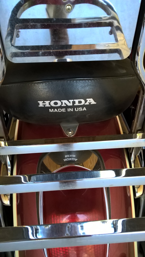

My Valk's old enough to have it on the seat.
rug_burn
« Reply #4 on: May 02, 2019, 07:21:30 AM » |
That's funny- it's the kind of thing I'd do- emphasizing the 'Made in USA' aspect...
