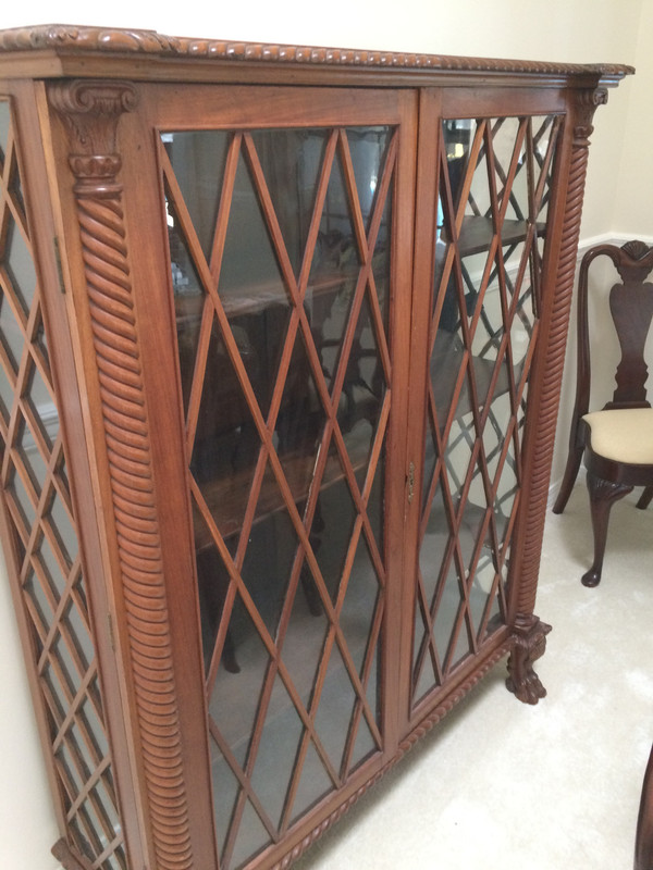

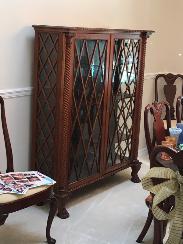

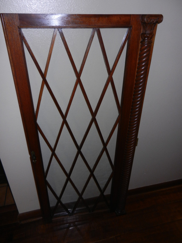

I have as part of my business the opportunity to repair lots of other peoples furniture.  This time a true antique China Cabinet was terribly damaged.  It had to be fixed there was no living with it the way it was.  The movers punched a hole right through the glass and tried to stick it all back together with gobs of wood putty.  It was a sad thing to see
This is the Cabinet

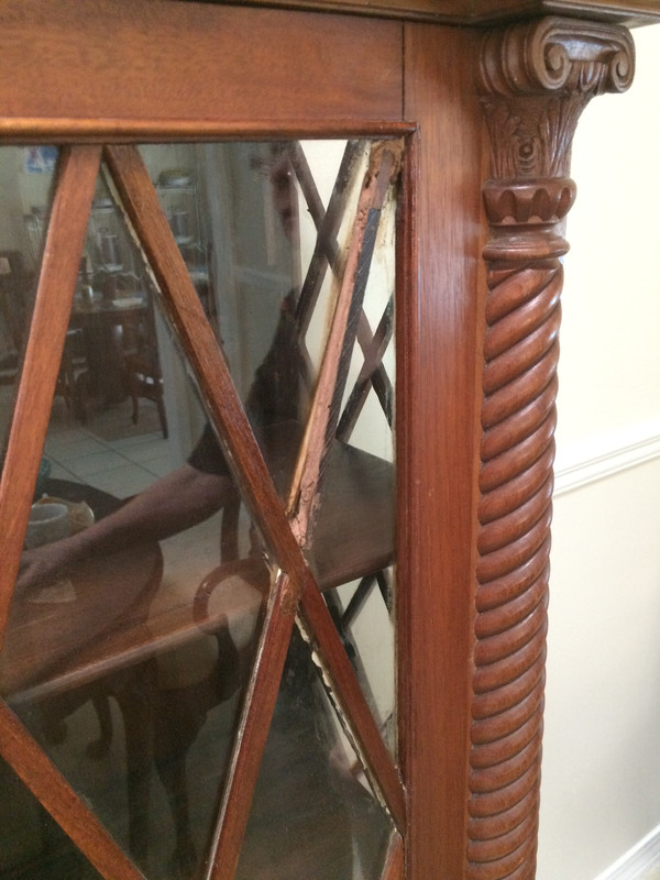

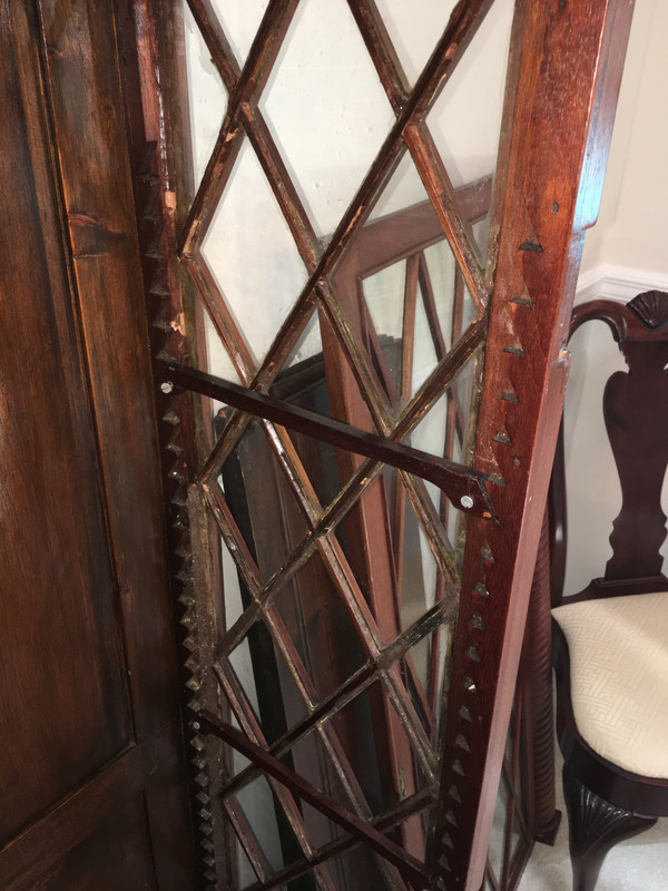

The door was only damaged in the the top outside corner

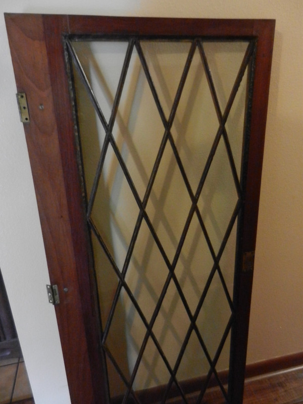

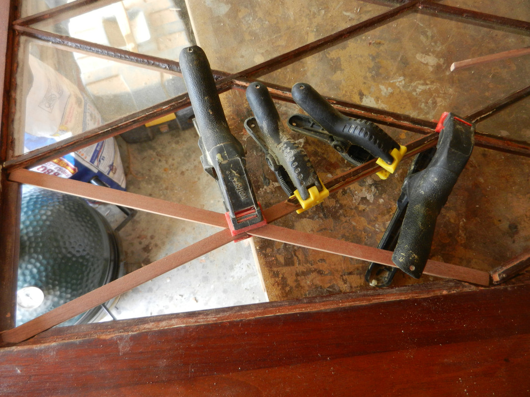

The damaged wood had to be removed and new wood patched in and then new glass and putty and paint and stain and epoxy.  But when it was all done it really looked like it went back in time to before it was damaged
Heres the finished door
Back
Front

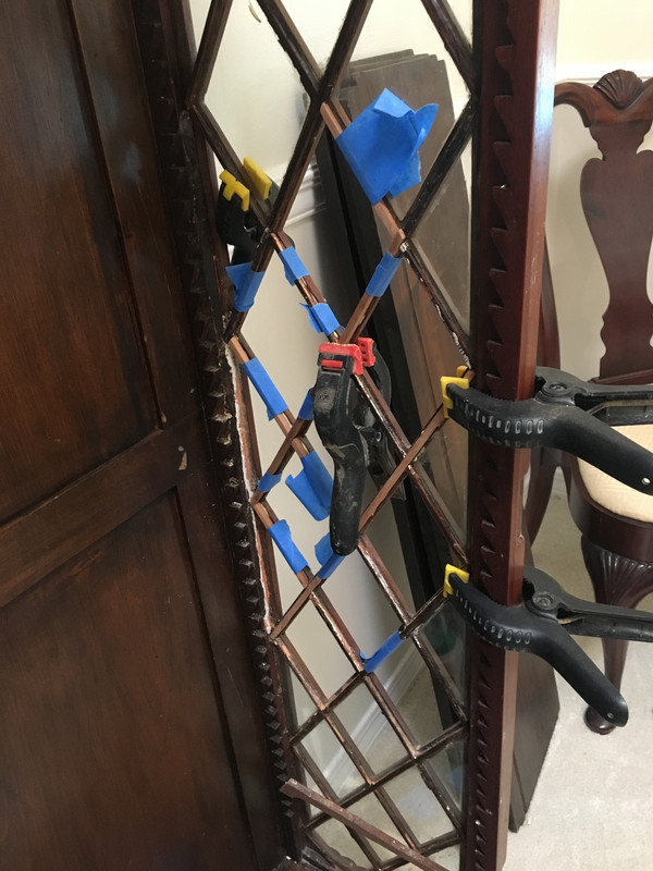

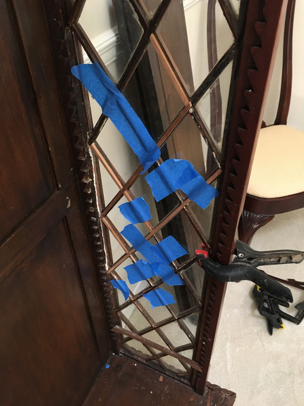

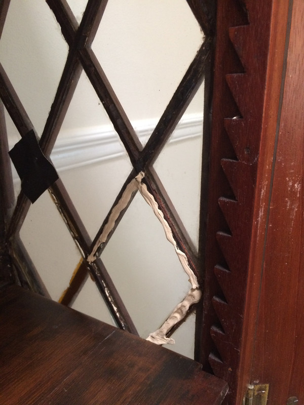

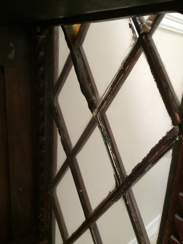

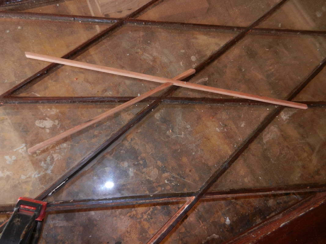

So I tear into this mess
I had to remove way more glass than I thought.  so it took all day and I still have to go back again

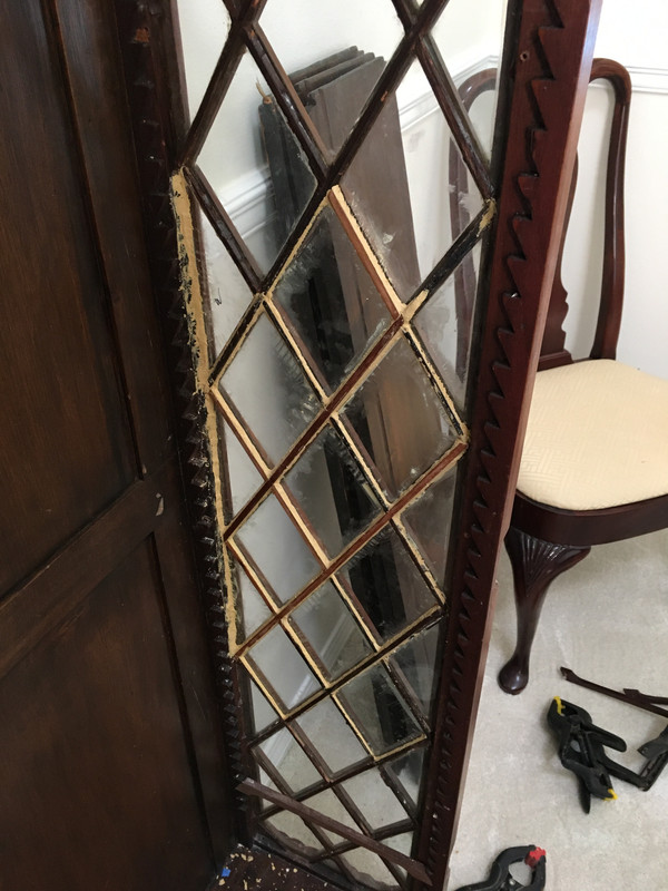

After removing the glass and cleaning up the gross putty I pieced in all the glass dividers that were missing.  This end of the cabinet was repaired at least twice
Then I had to re cut all the glass to fit and use some new glass as well so all the individual holes were filled
The last guy that "fixed" this piece goobered in large pieces of glass instead of doing it right like I did
Then putty in the glass the RIGHT way
When I go back on Monday I will only have to stain the wood and paint the filler and clean the glass.  This will be done!

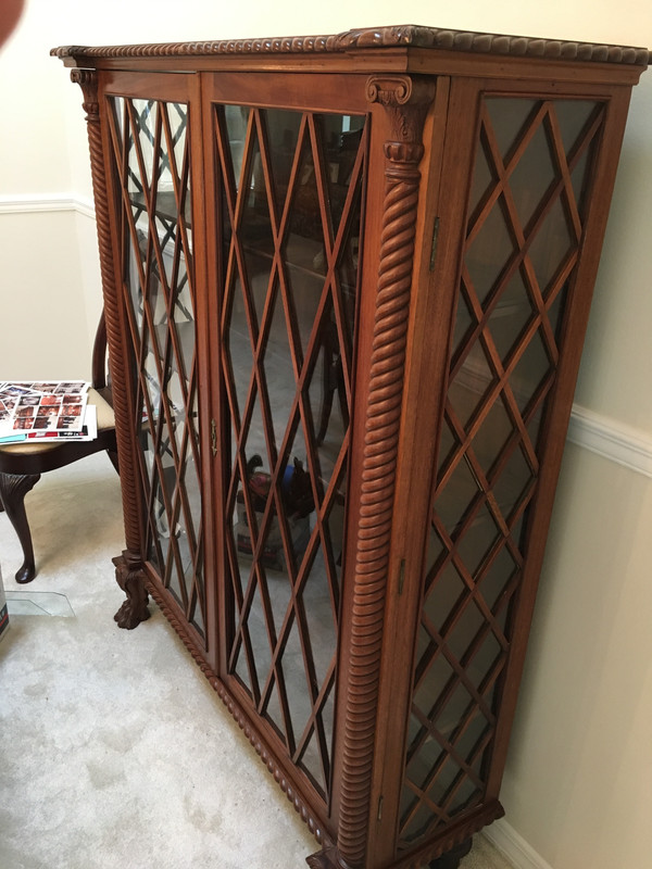

Well, all done.  Customer is very happy and the check is in the bank.  this is the inside of the side panel that had all that gooped on white wood filler and the large pieces of glass that just looked horrible
The outside of the side
The damaged (now fully restored end)
The whole piece now just as good as new
