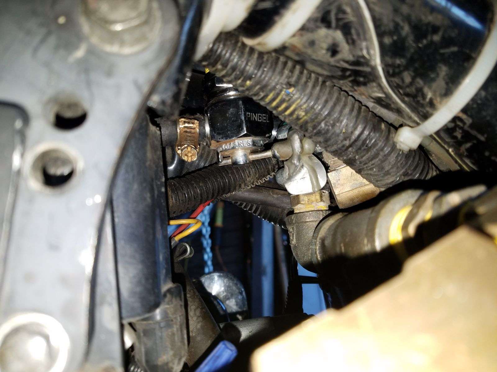

Have been using a Pingel petcock for many years and find it really easy to access while riding.
Vacuum hose leak on #6 left me stranded once before I knew enough about the Valk.
Also had a hydro lock close call with the stock diaphragm petcock. (added inline fuel filter too)
Simple is best. Never liked the look of that chrome plated plastic petcock knob.

I've gone to Pingel on George and Jade.  Found you can make the access to the lever better if you JBWeld a paddle on the lever.  For me, still need to be bare-handed.  But I pretty much never need to move the lever anyway on Jade, with a Dan-Marc, belly tank setup as super-reserve, and now an IS tank provides 326miles to the fumes with average 34mpg.  I've never used reserve on George either.  I always shut off the fuel - have to reach it from the right.  I suspect hydrolock isn't a threat with it's single carb and maybe the geared-lobe-type Magnacharger but I shut the pingel off anyway (don't know if that seals against leaking gas).  Superstitious.

Tested my -023 petcock conversion this past week. Works good; flows adequate fuel even at high speed.
There is another similar petcock which caught my attention. The P/N is 16950-MAL-603, and it's the part used on the CBR600F2/F3. I took a chance and ordered one for comparison purposes.
This petcock comes with a stand tube installed. It's 71mm in length (from the edge of the nut to the top of the tube) whereas the Valkyrie petcock's tube is 86mm. The screen which comes with the petcock is 33mm longer than the Valkyrie's screen, and the support boss (where the little rubber stand tube spacer fits) is located where it'll engage the end of the stand tube in its intended application. You can't use a Valkyrie screen set with this length of stand tube, as the center of the screen isn't adequately supported.
There are two options:
  • Measure the amount of clearance inside the tank, and if adequate use the -603 supplied screen;
  • Remove the stand tube from the petcock, replace with the Valkyrie-specific part then use the Valkyrie screen set.
Note that you'll get a little longer range on the main ('ON') setting and a little less range on Reserve should you use the 71mm stand tube. Also note that there may be insufficient clearance in a Standard/Tourer tank to use the longer screen. When next I have a tank/petcock off one of my Valkyries I'll measure the depth into the tank and see if adequate clearance is present. FWIW, both on my F6s have I/S tanks...so YMMV.
