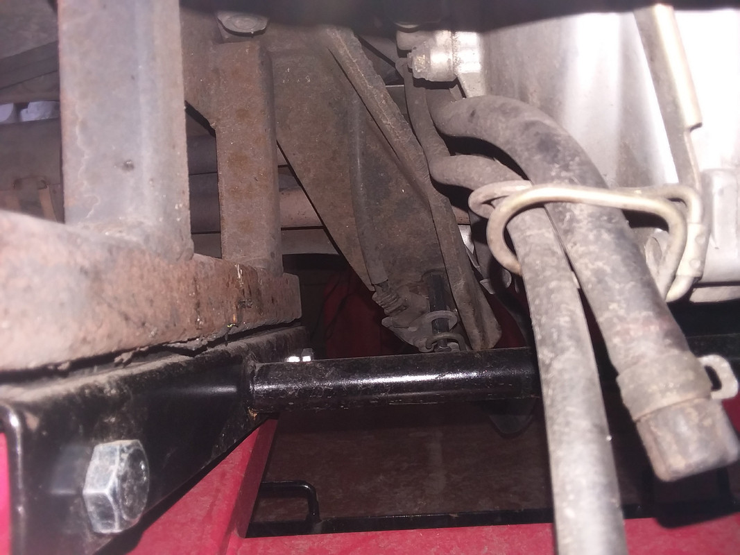

« Reply #11 on: June 19, 2019, 06:30:14 AM »
Having read on the forum about bike lifts causing damage to the kickstand bolt I checked mine when I did my oil change this morning.
It looks like the bike lift cross member is close to the bolt but it's a couple of inches away.
