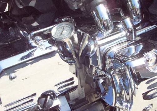

There is a Tel Tru temperature gauge you can buy to replace the dipstick.
There is no wiring or mechanics involved.
As long as your bike is under (or at) 220 (and your fan and thermostat are working), you are OK.  Measuring heat at the radiator and not the oil may be a bit better, but not enough to worry about.
I have them on both my bikes.  You can look down and read them.
They come with 2 size gauge heads, 1 3/4" and 2".  I prefer the two inch, but with the Kuryakyn transmission covers, the edge of the gauge just touched the cover and they are now marked, slightly.
The gauges are marked with an oil line, but I don't use them to check oil, I use the OE plastic one for that (in my toolbox).  They may be accurate enough, I don't know.
You must snug them (only) with a wrench on an Oring, not by grasping the dial head, or you will alter the temp calculation (which can be reset using boiling water; at 212* sea level).  They snug up so they can't be stolen (easily).
This way you don't have to guess.
https://www.teltru.com/s-95-honda-motorcycles.aspx
Mine do not sit as high as in this picture.  Maybe people complained about it hitting the tranny cover, and they made them taller, I dunno.
I placed a sliver of black electrical tape at the 220 degree mark on the dial face, as a benchmark, because I don't wear bifocals to ride.  Looking down while riding or sitting, as long as the temp sweep is below the benchmark, I am good.  I have never hit the benchmark while looking (and I check often in stop and go on hot days).  I will never sit in 90+ degrees at idle for more than a couple minutes.  I'll shut down and restart when I can move.
I don't know for sure, but am thinking good synthetic may run a few degrees cooler than dino. (?)

Subjectively these bikes can throw a lot of heat off, but overheating is a pretty rare problem. When it does occur, it's usually either a false alarm (the older bikes had a little box just to control the hot light, that box sometimes malfunctions and can make the hot light illuminate or flicker when the temp is still normal), or it's because the fan isn't working in slow traffic.
The tel-tru dipstick is definitely the easiest/cheapest/most reliable way to have a temp gauge. Oil temp is generally slightly higher, and slightly lags behind water temp, but in a liquid cooled engine they stay pretty close. They're about $80 and of course install is as easy as screwing in a dipstick. Mr Gasket does make a rad cap with a temp gauge built in for about $40 that fits, but I decided to pass on this after seeing numerous reports of these leaking. My 21 year old original cap was starting to dribble a bit, leading to dried coolant stains on the upper hose and tank after rides. Just replaced it with a new OEM and the problem vanished.

« Reply #22 on: June 29, 2019, 03:49:27 AM »
I installed water temperature gauges on 4 of my 5 Valkyries.
Both Tourers and both Interstates show/showed 185 degrees F when ridden on flat ground @ highway speeds and an ambient temperature of 80 degrees F. Increase the ambient to 90+ F, run them up very long inclines (especially with a passenger) and I'd see water temps get close to 200 degrees F.
The fans kicked on at 225-230 degrees F indicated.
Air Wings and the rubber engine deflector being in place helped with driver comfort, particularly above 35MPH or so. I'd say these bikes run "warm" but you shouldn't see temperatures so great that the fan is constantly on, or the oil begins to break down.
Hi John, Can you post a picture of your temperature gauge. Thanks
