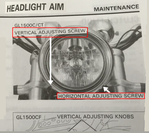

I need to know which way to turn the headlight adjustment screws for the movement I want. After installing the Darksider LED kit it's hitting quite high so need to aim it down more. Anyboty?
I realize I can go out and turn screws to my heart's content, just don't like to use the "by guess and by golly" shotgun approach.

« Reply #6 on: July 16, 2019, 06:32:20 AM »
I had the same question several years ago.  I do have an interstate so adjustments is different than standard/tourer..
I finally moved my Valk in my garage so that the light would shine on the back wall, turned off the lights, and started playing.  Its been several years ago so not real sure but seems that I turned the up-down adjustment to the right to get the light to rise.  It took a number of turns to get it where I wanted it.  would screw it, then set bike upright with me sitting on it to see the progress.  Like I said it took some time.
I believe putting in non OEM lights caused them to shine down more.
Posts: 15348
« Reply #7 on: July 16, 2019, 03:47:03 PM »
I got it done today, used my son-in-law's garage wall over 25' away. Found to lower the beam you turn the adjuster CCW. Brought it right in. I'll take a ride later when dark to see if I get any oncoming headlight flashes, if not I may raise it a tad.
