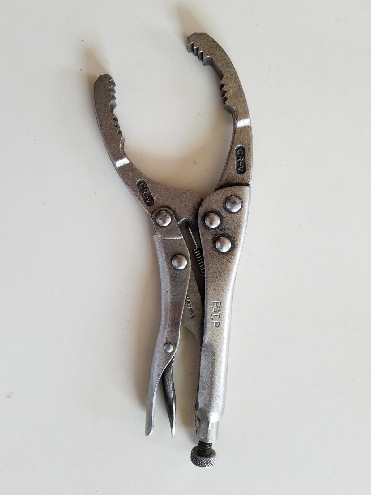

Here's another very useful tool.  I have several applications for it in my processes.  Not to mention removing a stuck oil filter.
Another tool you should have.  This strap wrench comes in a kit of two - this is the smaller one.  I keep the bigger one in my bike tools - great for adjusting Progressive 444 shocks.  Or turning any larger round object with force that you don't want to mar.  Or opening a beer bottle.
