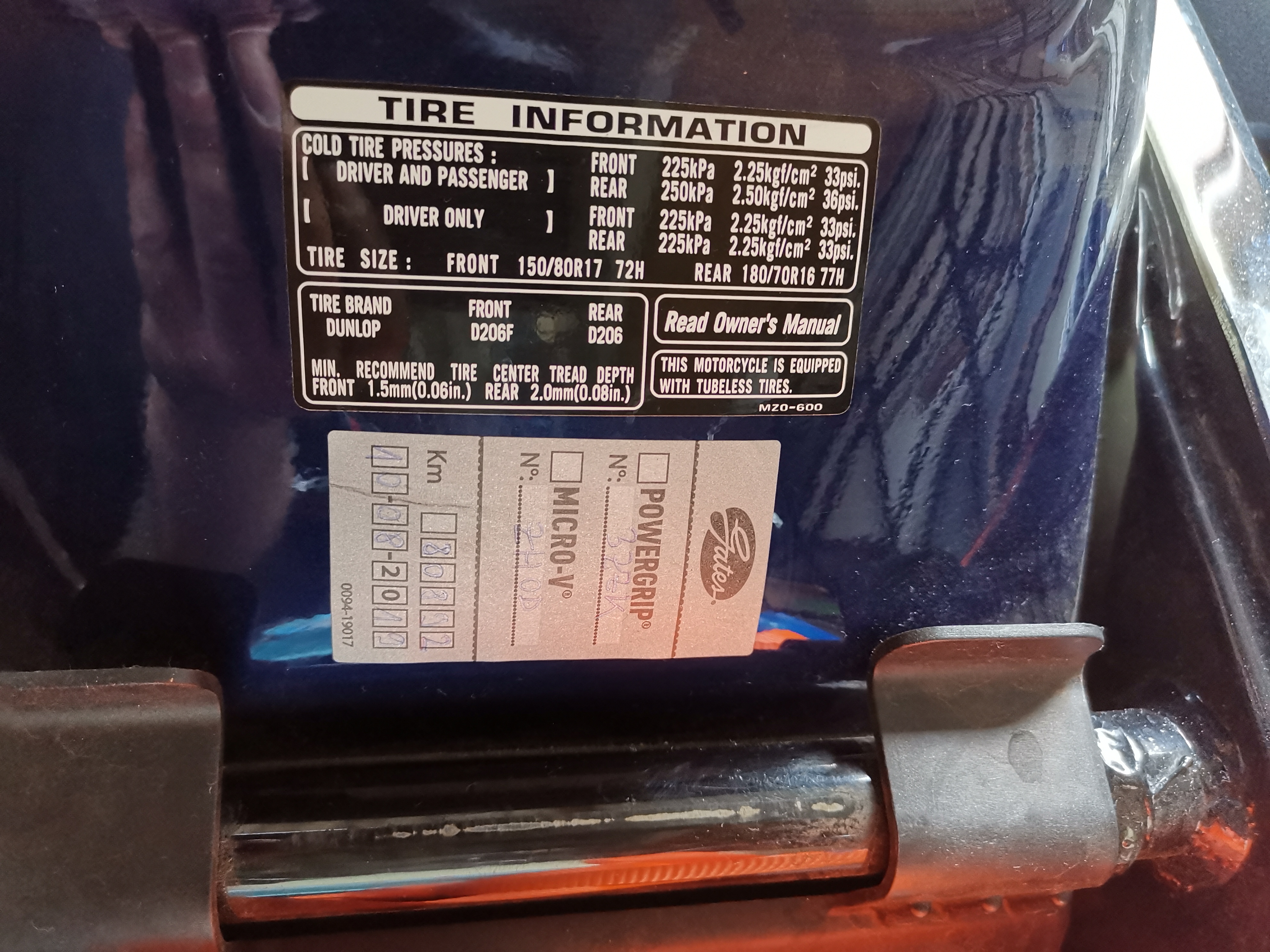

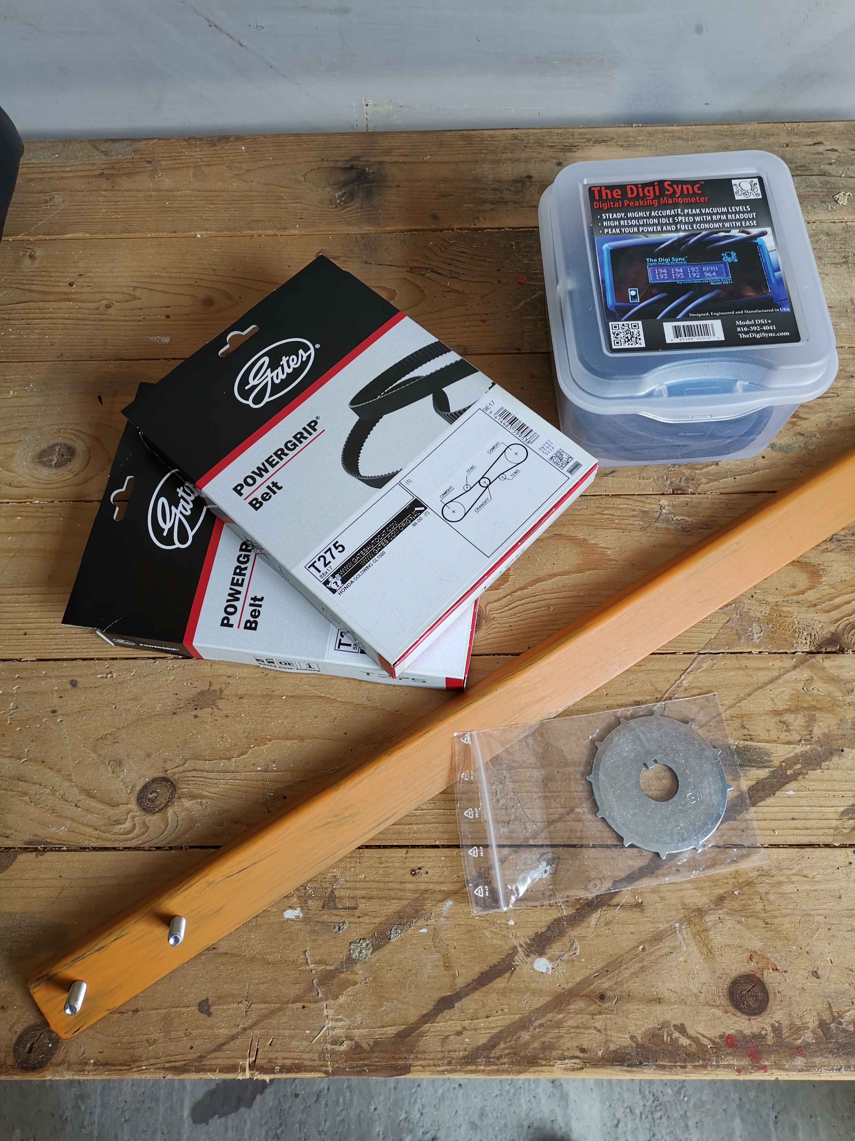

« Reply #8 on: August 24, 2019, 11:58:56 PM »
My European service manual stated "Replace at 160000km"
I bought my Lady a year ago with full service done. But after the discovery of a few "service short cuts" taken by the official Honda dealer  tickedoff , I decided to play it safe now at 80000km.
Gates belts for about 10 bucks a piece are a small price for riding without have to worry.
(A 4° Trigger wheel found its way into it, too Wink)
All in all - building the locking tool included - the job was done in an hour. Even for a noob like me.
The "old" OEM belts looked good as them have been changed recently, but a tensioner ran a bit coarse. So a new one jumped aboard, too.
I'll rebuild the old tensioner as found in the shop talk in winter.

Gate’s  T275 belts on Amazon run for a little over $16 each. It takes about 45 minutes to an hour to change them. Unless the tensioners need replaced (there’s a mod that costs about the same as belts) you’re probably set for the rest of the time you own and ride your bike.

Thank all of you,I have 2 new belts coming here tomorrow, which I have a service manual explaining  procedure.Does not look bad.I did check the intake and exhaust valve clearance s,they were all spot on
.I figured while I was there,to check them.Bike,by the by has 41K miles on it.

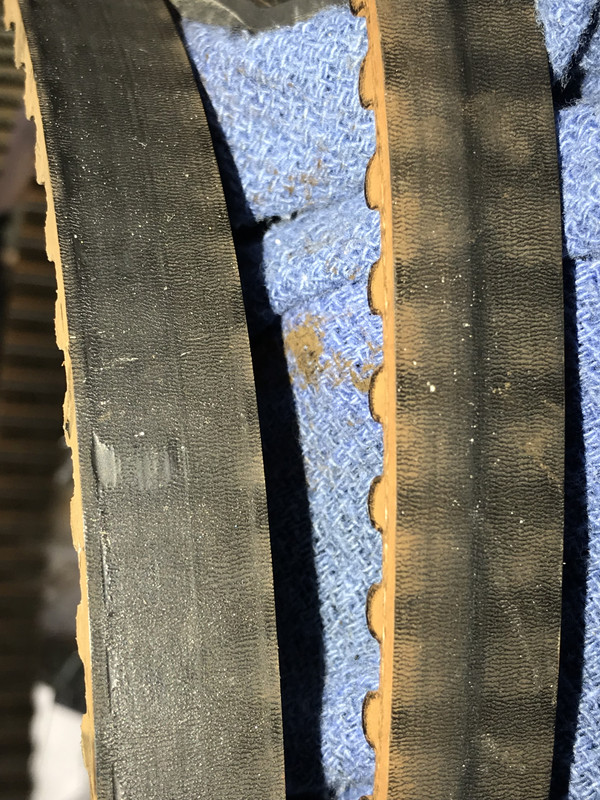

In the “for what it’s worth” category, from someone who actually quantifies data rather than speculates. Here is a set of belts from a 2001 Valkyrie with only 30K miles. These belts show clear signs of age and wear. Compared to new belts that replaced these, they don’t even compare. There are those who would state that they have no reason to change the belts because they showed no signs of wear. Well, my position is, no pictures, no proof. If one looks closely at the photos, it is clear that there are fractures in the base material. In addition, much of the material had sluffed off onto the accompanying tensioner pulleys. To put it another way, if you were buying a used vehicle and your mechanic pointed these belts out. Would you say “no problem, I see no signs of wear”?

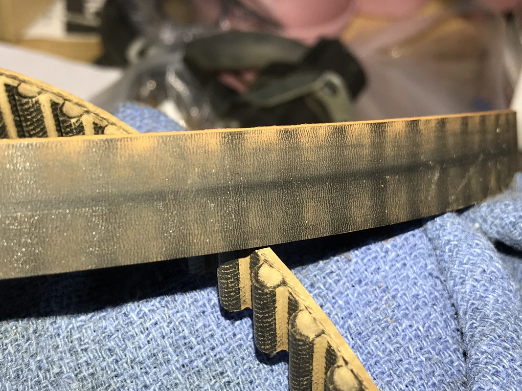

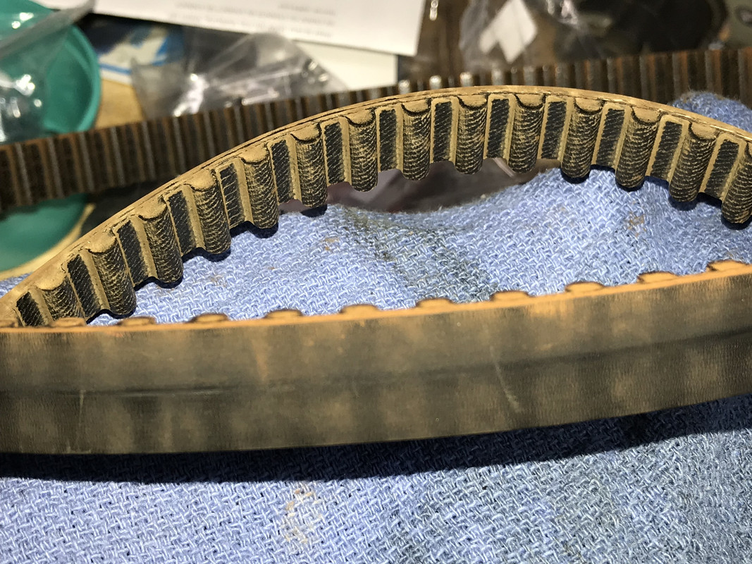

No, no pictures so it didn't happen. I Changed my 88' GW at 60K miles and 25 years. The belts looked pristine. I did replace them, for $45 USD it was cheap, and I wouldn't need t worry about it for another 25 yrs/100K miles.
I bent the belts every way I could, a tight bend, and no signs of cracking. Clean and no missing pieces.

I have pictures of mine at 125,000 miles. I don’t have a hosting service so can’t post them. In places you can still read the writing on them.  They’re cheap enough that I’ll replace them every time I’m into that part of the engine, but not because they need it, just because I need it.
