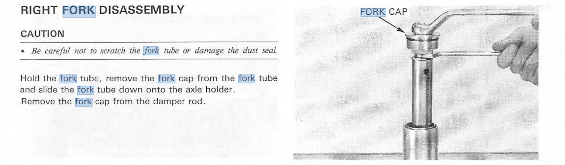

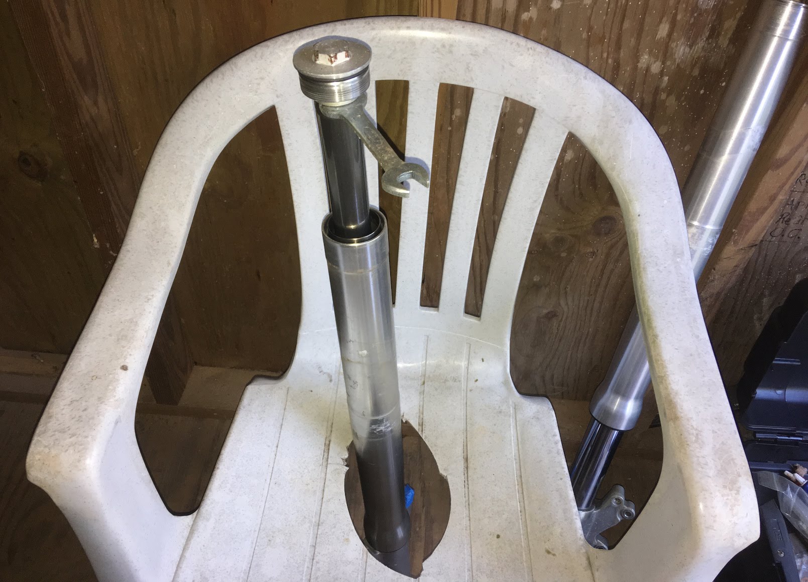

I don't want to take the forks apart in the dirt, so I moved them to my plush well lit
maintenance facility where my special fork tools are. I started on the right fork,
one of the first things to do is remove the cap from the damper rod...
I put the right fork in my special fork holder and dagnabbit, none of my 17 mm wrenches will
fit, they're all too fat. So I looked in the toolkit that came with the bike and sure enough, there's
a low-profile wrench that fits perfect  cooldude
I got the locknut, spring collar and spring out, cleaned the STINKY fluid off them and poured
the rest of it into a collection pan. At that point it was near time for supper so I stopped for
the day. Tomorrow I'll start with removing the bolt that's in the bottom of the right fork. The FSM
kind of blithely notes: if the fork damper turns with the socket bolt, put everything back together
and see if that helps

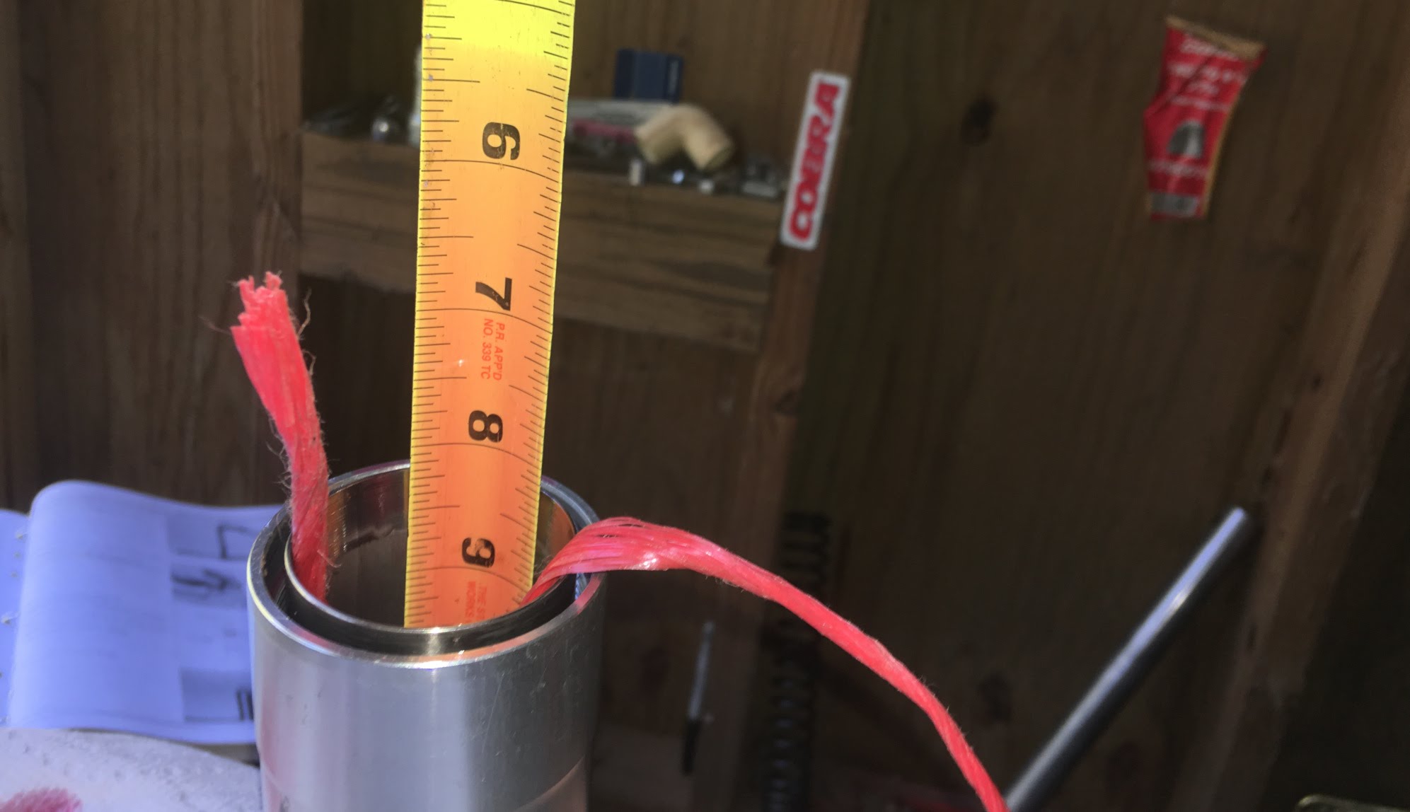

There was a recent thread here about filling the damper unit. I tied a piece of hay-bale-string
under the lock nut, poured half a bottle or so of fluid into the fork, and raised and lowered
the damper rod until the damper unit seemed full...
https://www.youtube.com/watch?v=Tikm2dBQ56I&feature=youtu.be
I measured from the top to gauge the right amount of fluid (different in each fork leg)...
It was kind of tedious getting the string off while trying to slip the spring seat stopper
back in, but not too bad.

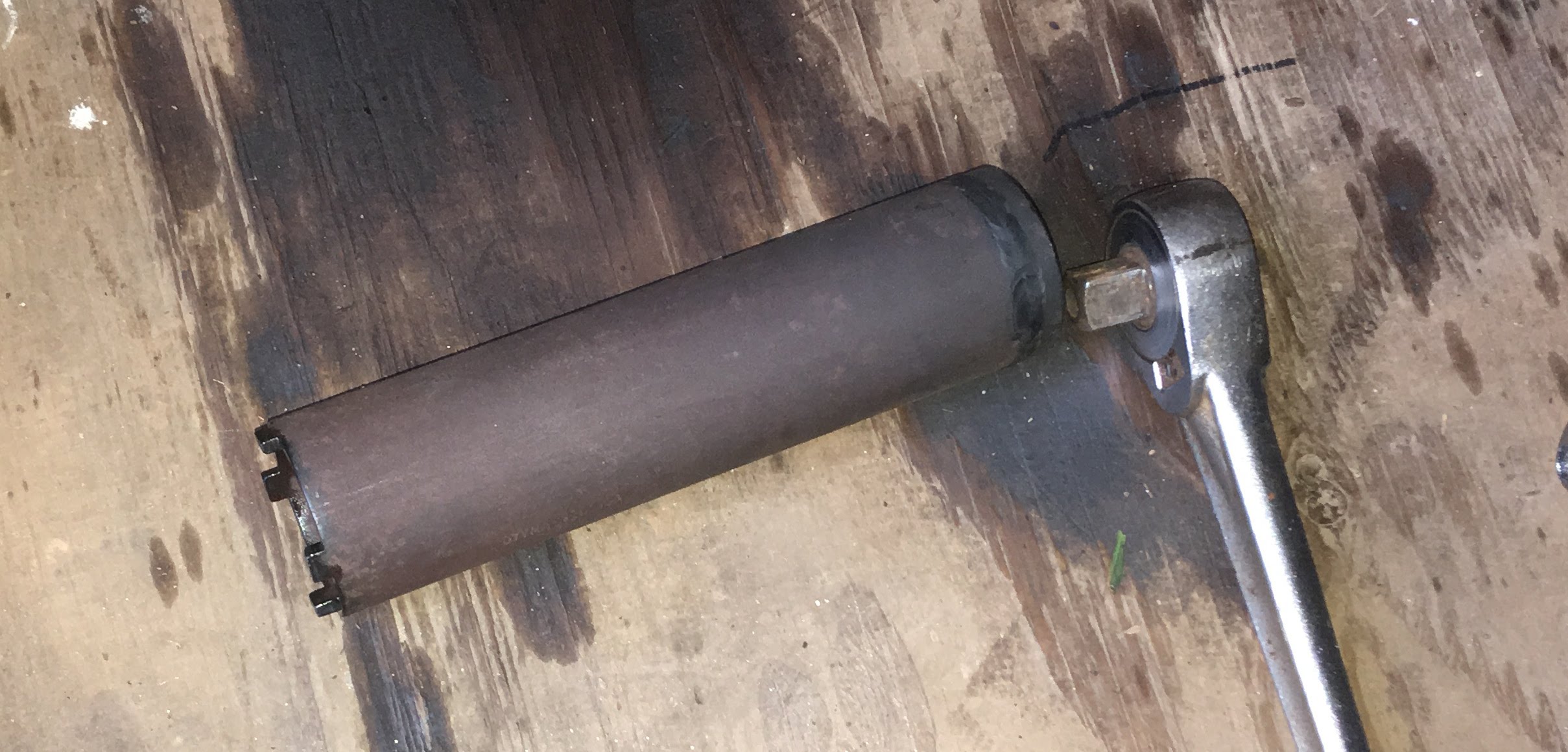

I got one of the left fork special tools back when I did the job in 2007, some people
make one out of some kind of water heater part or something...
