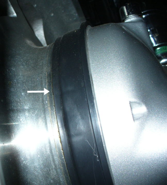

I'm putting my rear wheel back on after changing tires. It seems to me that the flange seated in just fine. But the right side where the piece of plastic touches the wheel it looks like there is a gap it should touch. It's all back together and it fit fine. Could it be that it's not all the way on, could someone post a picture of where the plastic meets the wheel of an installed tire.

I remember worrying about that gap... you're good to go I'm pretty sure...

Normal!  cooldude

Is the thrust washer installed? Is the wheel itself worn from maybe the previous owner not using the thrust washer?

It's not visible in the pic, but mine's was tilted or sumpthin and the lower quadrant was frayed from rubbing against the wheel. I was worried about that more than the gap (arrow).
So is this a picture of it installed correctly?

I did a bunch of looking before I decided to be a "do it yourselfer" followed all the steps in the shop talk article. It just didn't look right when I got it back on! Thank you everyone for the help!

I just went thru quite a few gyrations on the wheel seating correctly and all that. So I know mine is good.
On a quick eyeball check, I would say the gap is 5/32 inch....
Affirmative. It may seem that the dust shield should go flush to the ridge, but try as you might, the dust shield cannot go any further over the groove.

Here's mine.. Ron and I are having a photo contest...  Wink
