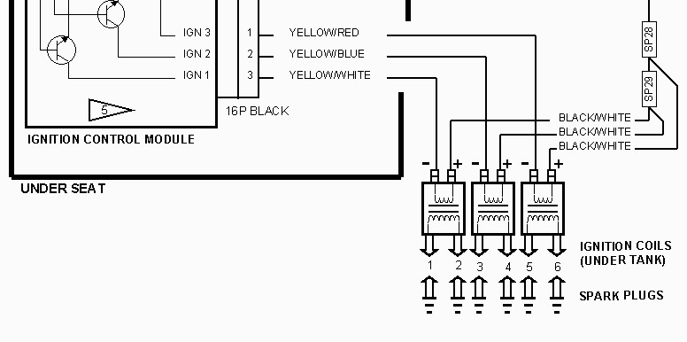

Ricky D brought up a good point a number of posts bike about the guy that had spark plug wires crossed.
It does not have to be the actual spark plug wires but it could be the wires coming from the ECM to the coils.
Coil 1&2 has a Yellow/White wire
Coil 3&4 has a Yellow/Blue wire.
Coil 5&6 has a Yellow/Red wire.
Make sure that these are going to the correct coil.
« Last Edit: January 12, 2020, 11:29:18 AM by indybobm » Logged

Indybobm, what a coincidence you mentioned that, I just went over the wiring to the coils yesterday, no dice, they're right and like I wrote above, they check out with the timing light.  Was really hoping to be on to something with that.

-When I unscrew the coil for 1&2 (the one on the left side above the carbs) I unscrew the big ground connection there.  I have accidentally run the bike a few times with that ground disconnected  and notice no difference.  Should I be noticing anything unusual when it is disconnected?
I would check the grounds to the coils to make sure that they actually go to ground. You might also connect additional grounds to the coils to see if that helps. Also might check the ground on the pulse generators. I would also check the battery ground to clutch cover and ground between the battery and bike frame. I would think that removing the ground wire from the coil should cause a difference in how the bike runs.
« Last Edit: January 13, 2020, 06:21:00 AM by indybobm » Logged

indybobm, that sounds like a good idea. I'll be checking the grounds and wiring over the course of this next week.

Green/White would be grounded if the side stand is up or the clutch lever is pulled in. The only Orange/White wire I see would be grounded through the Left Front running Light filament.
Back to the coils. Again, I would think that if you remove the ground wire from a coil, it should make a difference in how the engine runs. If it does not, then it might not be actually grounded. You could try to remove the ground from the other two coils to see what effect they have. If a coil is not grounded, it will seek essentially a ground through other places and result in a spark that might not be adequate under a high load condition. Just a guess on my part.
my coil mount bolts had rusty threads and the coil faces were rusty and that caused and interitten serious miss , certainly somewhere to look for him Smiley

Ricky-D
Posts: 5031
South Carolina midlands
« Reply #74 on: January 16, 2020, 11:50:32 AM »
The actual coil being grounded is for the actual produced spark to find it's home.
The production of the spark is thru a ground supplied by a "switch" inside the ECM, and there is a positive charge
being constantly provided to each coil to facilitate the production of the spark.
2000_Valkyrie_Interstate

Ah, thanks for the info on coil operation Ricky-D.  Sounds like it probably wouldn't be a good idea to create a constant ground to override that switch...
