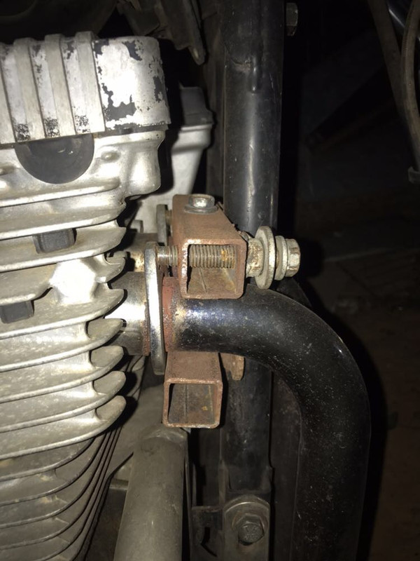

This was a fun one. Some exhaust bolts snapped. So we built an “outrigger” that uses the frame to push the manifold to the engine.
