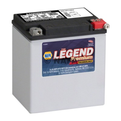

I just got another NAPA Legend battery to replace my 8 year old battery in one of my bikes it was $ 109.00 out the door. The one NAPA Legend I took out was still good replaced for peace of mind after doing some maintenance and seen how long it had been in there. Couple cool thing I like about these battery's is that you don't have to worry about that stupid little square nut . Comes with two sets of screws one long one short depending how many accessories you need to hook up and 8 years old and still good on my last one.

I am not yet certain what I will buy for it but that NAPA Legend does look interesting.  A Yuasa agm is what I had in it.

Just changed ALI's battery out last week... Thanks to suggestions on this board, and like SmokinJoe, I went with the NAPA Legend this time... Really looking forward to a nice long life outa that 'un... My last couple had been expediency purchases while on a road trip, so WalMart usually got the nod, because there is always one close-by... This time the old one died at the house, so I took the plunge... Good luck!

I believe you chose well with that NAPA Legend.  You probably won’t be using the jumper function of that rugged geek for a long while now.  I tested my rugged geek on a diesel tractor a couple of weeks ago.....it impressed several of us.
